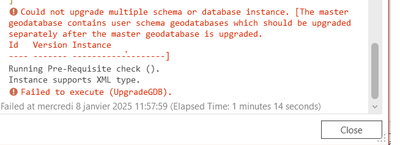

Hello Community,
I am trying to upgrade an Enterprise Geodatabase from the version 11.1 to the version 11.3, running on Oracle Database 19c Enterprise Edition Release 19.0.0.0.0 - Production
Version 19.24.0.0.0.
But I am receiving the following error:
Could not upgrade multiple schema or database instance. [The master geodatabase contains user schema geodatabases which should be upgraded separately after the master geodatabase is upgraded.
Id Version Instance
It is weird because I am connected with the SDE user and I am sure that it is the master geodatabase schema.
Is there an efficient way to query this error in the database admin tables?
I already upgraded other geodatabases using the same ArcGIS Pro installation, and it worked normally. It discarded the possibility to be a problem with the ArcGIS Pro, Oracle client or Oracle version.
Did somebody had similar issue recently?
Any help would be much appreciated.
Thank you.
KR
Felipe

VinceAngelo
Esri Esteemed Contributor
User schema geodatabases have been deprecated for more than four years. Are you sure this is even possible?
- V

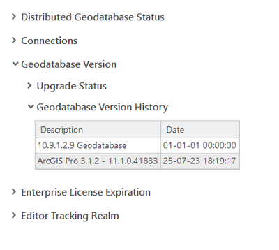

Felipe
Hi @VinceAngelo , thank you for your answer!
Indeed, it is very strange, and the message shows an empty list when I get the error:
More or less 6 months ago, this database has been successfully upgraded from 10.9.1 to 11.1, with no errors:
Do you think the error is coming from some corrupted table?
Thank you!
VinceAngelo
I think the deprecation is being enforced by 3.3/10.3.
- V
