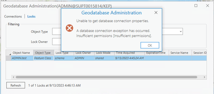

The data owner only has the privilege to view the existing locks at the dataset level by the following steps:
>>Start ArcGIS Pro and connect to the geodatabase as the dataset owner.
>>Right-click the dataset in the Catalog pane and click Locks.
If you want to delete the locks, we need to connect with the Geodatabase administrator user, which is sde user. Please check the "View locks on your dataset" section in below document:
Manage geodatabase locks
Even though I am able to see the existing locks on my dataset with the data owner, however, when I click on disconnect, I see below error related to insufficient permission:
