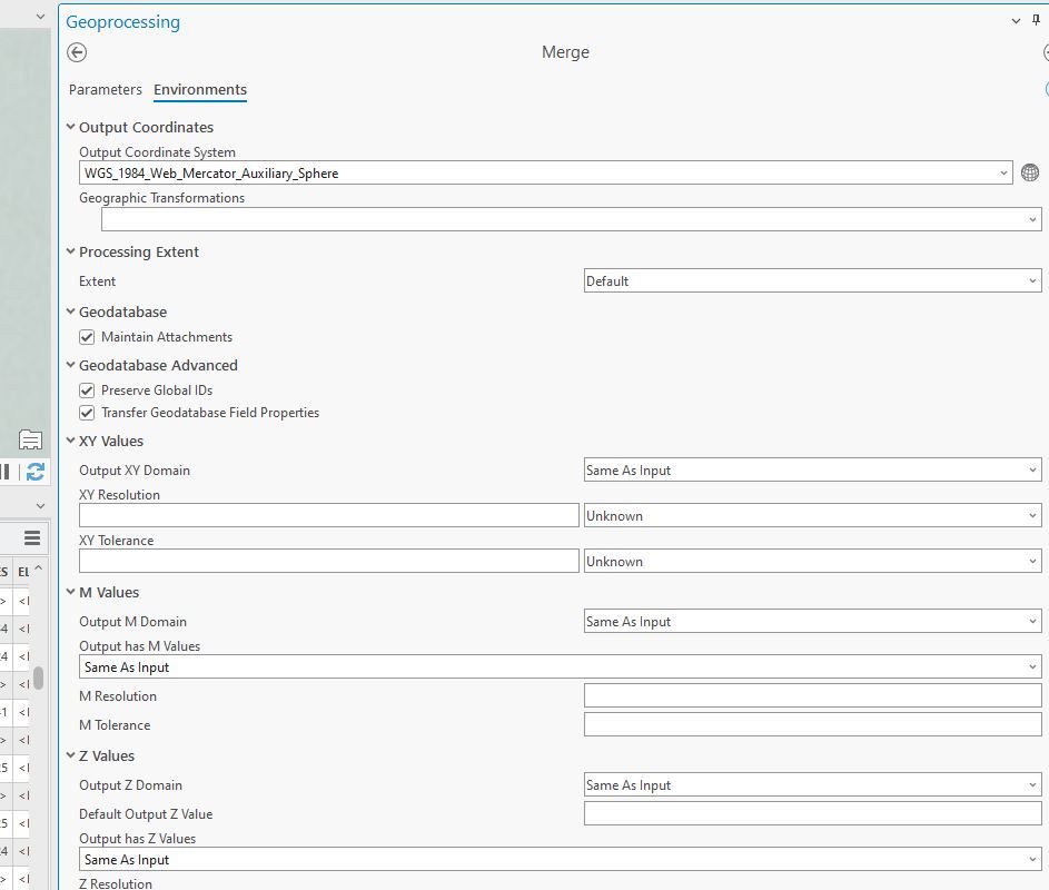

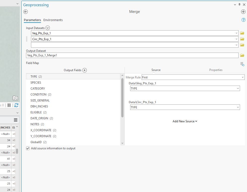

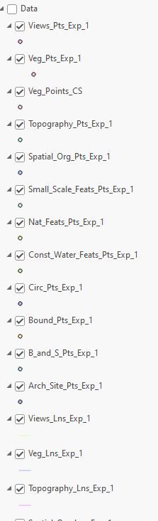

Following up with screenshots.Settings for merge 1.JPGSettings for merge.JPGData to Merge.JPG
MarceloMarques
How do I keep the domains intact and properly populated in the new output?
Check if the output geodatabase featureclass field has the domain and if the domain is assigned to the field.
You can export the geodatabase schema to xml (schema only, no data) then import the xml into a new geodatabase to create an empty geodatabase schema that has the domains, and has the domains assigned to the fields, then you can use the data append tool to load (merge) the data from multiple sources into the empty geodatabase schema.
