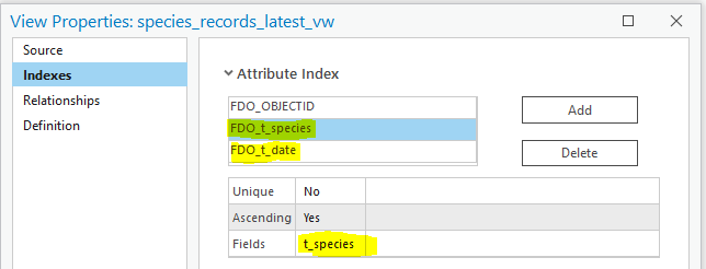

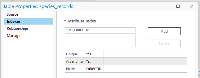

I have a table that doesn't have any attribute indexes (other than the default ObjectID index):
And I have a database view:

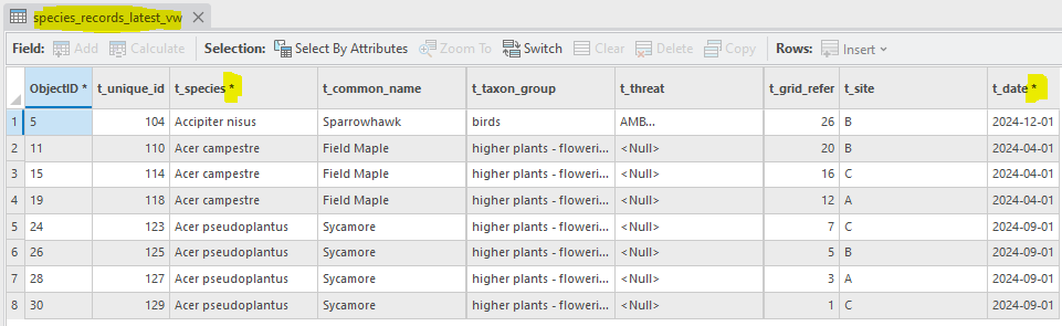

The view's properties and the attribute table headers both indicate that the view has indexed fields, even though the underlying table doesn't have indexes.
Do FGDB database view fields really have attribute indexes?
I've heard of indexed views in SQL Server and materialized views in Oracle. But those mechanisms need to be set up manually. So I'm surprised to see FGDBs automatically index certain fields in a database view, especially when the underlying table isn't indexed.

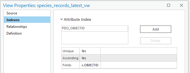

Bud
Legendary Contributor
In the outer query, if I use a table alias instead of SELECT *, then the resulting view doesn't have indexes.

So that makes me wonder if this is a bug.
I've seen other strange behavior with SELECT * in FGDB database views too. And using a table alias has solved those issues.
