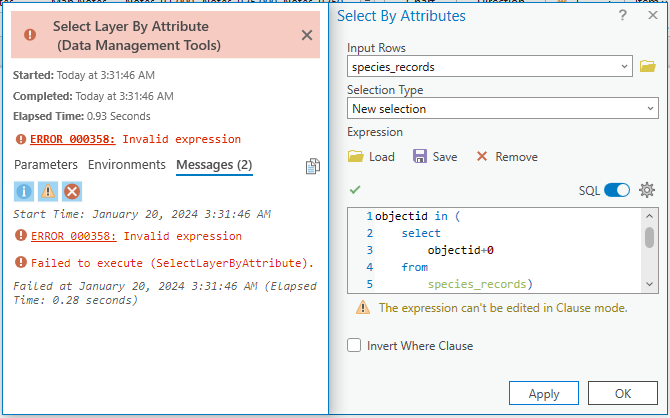

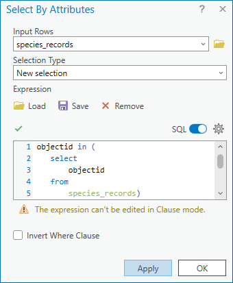

In Select by Attributes, this works:
 objectid in (
    select
        objectid
    from
        species_records)
But this doesn't work:
objectid in (
    select
        objectid+0
    from
        species_records)
ERROR 000358: Invalid expression
Likewise, any other SQL expression throws the same error, including expressions on text or date fields.
Why does a SQL expression in the SELECT clause of a subquery throw an error in Select By Attributes?
I don't have that problem in mobile or enterprise geodatabases, only file geodatabases.
