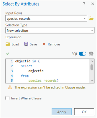

In Select by Attributes, this works:
 objectid in (
    select
        objectid
    from
        species_records)

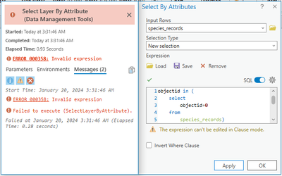

But this doesn't work:
objectid in (
    select
        objectid+0
    from
        species_records)
ERROR 000358: Invalid expression
Likewise, any other SQL expression throws the same error, including expressions on text or date fields: casting a date to text, string concatenation, or changing text case using the upper() or lower() functions. Even selecting a constant/literal like 1, ‘a’, or null throws an error.
In other words, simply selecting a column works, but anything other than that throws an error. I don't have that problem with mobile or enterprise geodatabases, only with file geodatabases.
