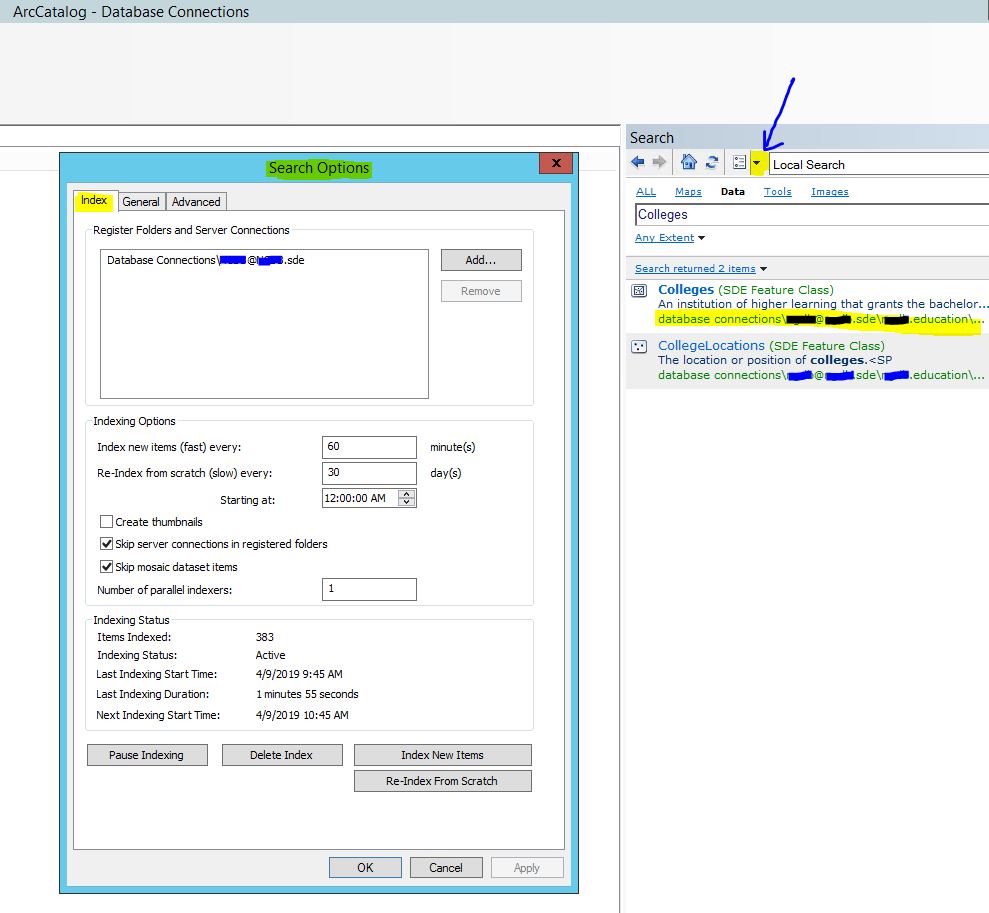

If the Database Connection is indexed, you can directly search in the Desktop interface.
Using search in ArcGIS—Help | ArcGIS Desktop

Hi Jose
You can use the script below in ArcCatalog's python window (Change fcName and pathToSDEConnectionFile)
<SPAN class="comment token"># Feature Class Name (E.g. TestDB.DBO.TestPolygonFeatureClass)</SPAN> fcName <SPAN class="operator token">=</SPAN> <SPAN class="string token">'TestGDB.DBO.TestPolygonFeatureClass'</SPAN> <SPAN class="comment token"># Path to the sde connection file </SPAN> pathToSDEConnectionFile <SPAN class="operator token">=</SPAN> r<SPAN class="string token">'C:\tmp\sdeConnections\localhost.sde'</SPAN> arcpy<SPAN class="punctuation token">.</SPAN>env<SPAN class="punctuation token">.</SPAN>workspace <SPAN class="operator token">=</SPAN> pathToSDEConnectionFile datasets <SPAN class="operator token">=</SPAN> arcpy<SPAN class="punctuation token">.</SPAN>ListDatasets<SPAN class="punctuation token">(</SPAN>feature_type<SPAN class="operator token">=</SPAN><SPAN class="string token">'feature'</SPAN><SPAN class="punctuation token">)</SPAN> datasets <SPAN class="operator token">=</SPAN> <SPAN class="punctuation token">[</SPAN><SPAN class="string token">''</SPAN><SPAN class="punctuation token">]</SPAN> <SPAN class="operator token">+</SPAN> datasets <SPAN class="keyword token">if</SPAN> datasets <SPAN class="keyword token">is</SPAN> <SPAN class="operator token">not</SPAN> None <SPAN class="keyword token">else</SPAN> <SPAN class="punctuation token">[</SPAN><SPAN class="punctuation token">]</SPAN> <SPAN class="keyword token">for</SPAN> ds <SPAN class="keyword token">in</SPAN> datasets<SPAN class="punctuation token">:</SPAN> <SPAN class="keyword token">for</SPAN> fc <SPAN class="keyword token">in</SPAN> arcpy<SPAN class="punctuation token">.</SPAN>ListFeatureClasses<SPAN class="punctuation token">(</SPAN>feature_dataset<SPAN class="operator token">=</SPAN>ds<SPAN class="punctuation token">)</SPAN><SPAN class="punctuation token">:</SPAN> <SPAN class="keyword token">if</SPAN> <SPAN class="punctuation token">(</SPAN> fc<SPAN class="punctuation token">.</SPAN>upper<SPAN class="punctuation token">(</SPAN><SPAN class="punctuation token">)</SPAN> <SPAN class="operator token">==</SPAN> fcName<SPAN class="punctuation token">.</SPAN>upper<SPAN class="punctuation token">(</SPAN><SPAN class="punctuation token">)</SPAN><SPAN class="punctuation token">)</SPAN><SPAN class="punctuation token">:</SPAN> <SPAN class="keyword token">print</SPAN><SPAN class="punctuation token">(</SPAN><SPAN class="string token">'Feature Class '</SPAN> <SPAN class="operator token">+</SPAN> fc <SPAN class="operator token">+</SPAN> <SPAN class="string token">' found in '</SPAN> <SPAN class="operator token">+</SPAN> ds <SPAN class="operator token">+</SPAN> <SPAN class="string token">' Dataset'</SPAN><SPAN class="punctuation token">)</SPAN><SPAN class="line-numbers-rows"><SPAN></SPAN><SPAN></SPAN><SPAN></SPAN><SPAN></SPAN><SPAN></SPAN><SPAN></SPAN><SPAN></SPAN><SPAN></SPAN><SPAN></SPAN><SPAN></SPAN><SPAN></SPAN><SPAN></SPAN><SPAN></SPAN><SPAN></SPAN><SPAN></SPAN></SPAN>
