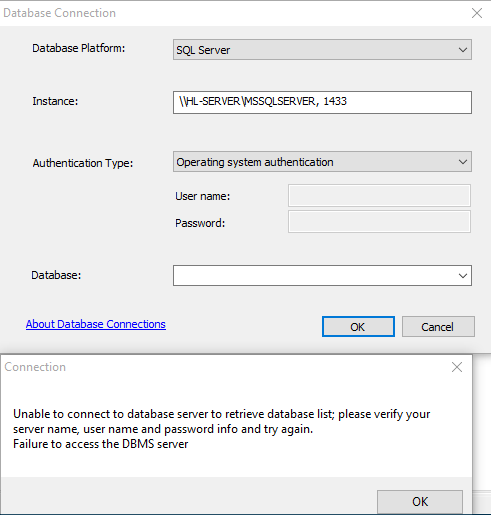

I installed Windows Server 2012 R2, ArcGIS Server 10.2.2 and SQL Server 2012 on my Server computer. I can create a GeoDatabase by use Create Enterprise Database tool.
I can use Arcmap in this computer to Add, Replace, Edit, Query data in this Geodatabse. But I don't know how to use this Geodatabse on another computer on LAN - which installed ArcGIS Desktop 10.2.2 and SQL Native Client. I turned off Antivirus and Firewall both Client and Server computer. But nothing change.
On Server Computer:
On Client:
I have tried
\\HL-SERVER\MSSQLSERVER, 1433
\\HL-SERVER\MSSQLSERVER@1433
\\HL-SERVER:1433\MSSQLSERVER
\\192.168.1.108\MSSQLSERVER, 14333
everything i can think out, but the same error
Can you tell me the parameter to enter in Instance and Authentication Type to connect to Database server?
Once again, i am sorry if any hard to understand, my English is not good ^_^
Thanks so much!

I stuff this problem 3 days. But now i can understand what happening... WOWWWWW
The Instance is: HL-SERVER\MSSQLSERVER,  1433
Authentication Type: Database authentication
user name: sde (i don't know why can't i use Administrator - )
pass: your database pass
taadaaaa
Wishing this information help you a little

ChadKopplin
I believe the issue with the administrator not working is that this account needs to be a site administrator for the database and it needs dbo rights, because it is trying to make a direct connect to the database with operating system authentication.  Thank you.

Using only //hl-server instead //hl-server/mssqlserver
