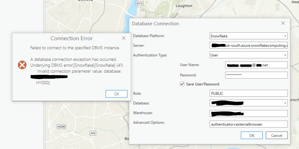

Hi everyone,
I am having issues connecting Snowflake with ArcGis Pro. I have installed the ODBC driver and followed all the steps but I am still getting a database connection error as visible in the picture.
The authentication is via Microsoft SSO which looks like is working because I am able to validate the connection through the app but then I get the error.
Do you know how I can fix this?

Hello.  We have experienced a similar problem with both ArcGIS Pro and ArcMap when installing version 18 of the ODBC driver.  When we installed version 17, connections could be created.  Sincerely, Jay

Are you using Snowflake as connection platform or SQL server? Snowflake ODBC driver is version 3.1.0
RudraniChakraborty
Hello, Maybe you can check the below documents for requirement with ArcGIS Pro 3.1 to connect to Snowflake database
https://pro.arcgis.com/en/pro-app/latest/help/data/databases/connect-snowflake.htm
