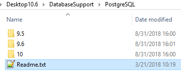

Look in this location for the libraries: C:\Program Files (x86)\ArcGIS\Desktop10.6\DatabaseSupport\PostgreSQL
I see the Postgres 10 folder.
