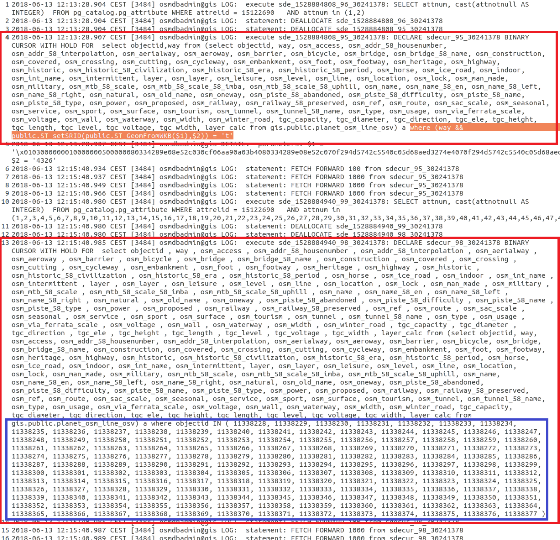

The Definition Query set on the layer, see image, references an indexed field, osm_piste_58_type:
If I insert the Definition Query in DBeaver IDE, and prepend it with the necessary SELECT...FROM... that is missing in the Definition Query itself, and run an execution plan, the query runs in less than 3 seconds (2163ms) and returns 38697 rows, so just under 40k records. The execution plan shows the database correctly using the available index ("Index Scan"):
The problem:
When I attempt to open the Attribute Table in Pro by right clicking the layer and choosing "Attribute Table", Pro, instead of showing the records near instantly as it should based on the 3 seconds execution plan, instead takes > half an hour to open the Attribute Table. This is the time needed for a full table scan. When it is finished, it does show the proper 40k records, so the final selection was made.
When I enable logging in PostgreSQL and check the created log, I can see the SQL generated the moment I open the attribute table. Much to my surprise, even though the Query Layer had a Definition Query set, this Definition Query is not set on the SQL send to the database to restrict the binary cursor being created, as a consequence, the entire table seems subsequently to start being scanned in chunks of 1000 records, see the FETCH FORWARD 1000 statements in the log. This seems to go on the entire half hour, until a full table scan of all the millions of records is done, and the final table is created. As I wrote above, the final result in the Attribute Table, does correspond to the Definition Query, and is only the 38697 rows.
To inspect this better, I copied both the cursor statement that is initially used to create the layer (which is fast!), and compared it with the above statement representing the opening of the Attribute Table in an OpenOffice document, see the below screenshots. Notice how the first screenshot, which represent the moment the layer is created when the Pro Map document is opened and the TOC layer generated, does contain the Definition Query in the WHERE statement. This WHERE statement is omitted though, in the second screenshot that represents the opening of the Attribute Table:
- Creation of Query Layer:
- Opening Attribute Table:
Am I missing something here, or fundamentally misunderstanding what is going on and misinterpreting this data? Why is there no WHERE statement submitted to the database when opening the Attribute Table of a (Query) Layer?

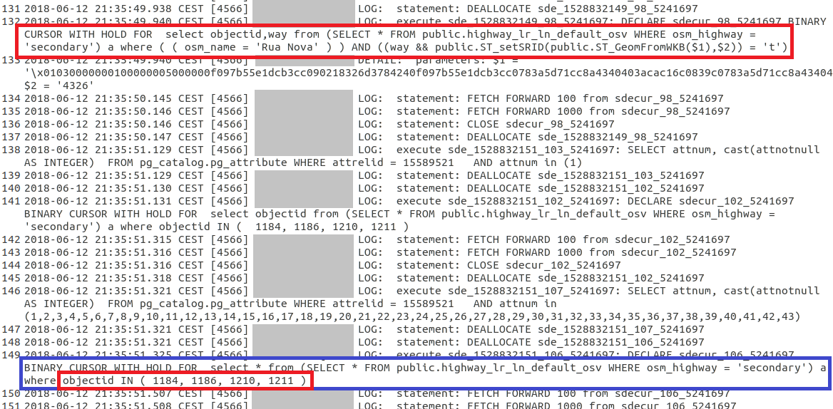

I think I have another interesting observation to share, that also reveals some of the "inner workings" of Query Layers, and their intertwinement with what ESRI used to call SDE but is actually the foundation of the access to databases in ArcGIS products.
If you look at the screenshot, you see again two SQL statements, this time run against a much smaller PostgreSQL database than the original one I posted about, but a comparable situation with a Query Layer. The first highlighted SQL statement was issued to the database once I clicked the layer visible in the TOC, and shows actually two WHERE clauses: one I added to the Query Layer's SQL statement directly: WHERE osm_highway = 'secondary', and the other one I added as a Definition Query of the same layer: where ((osm_name = 'Rua Nova')).
Further down highlighted in blue is the SQL statement that was fired when the I opened the attribute table. There are in fact four records that have satisfy the osm_name = 'Rua Nova' clause, however, interestingly, this clause is not included as the WHERE statement, but instead the actual OBJECTIDs of the records corresponding to the clause mentioned.
It appears, once a layer is created, all the OBJECTIDs corresponding to the layer's defining SQL statements, are likely kept in memory and submitted to the database in one long IN (...) statement. That is the "inner workings" I meant. So Pro does submit a WHERE clause in this case, even though it is not the one I expected.
Even more puzzling of course, is that this seems to work for this small layer, but failed on the giant 65M record layer. Now I am pretty sure, and there is of course no reason for this, that Pro won't attempt to build an IN (...) clause for 65M records all at once, which would probably fail, but instead likely only needs to build such IN (...) statement for the first 2000 records or so that an attribute table usually displays once it opens (you can't show 65M records on a screen at once...). But even this likely limited operation seems to fail in the case of this giant layer.
