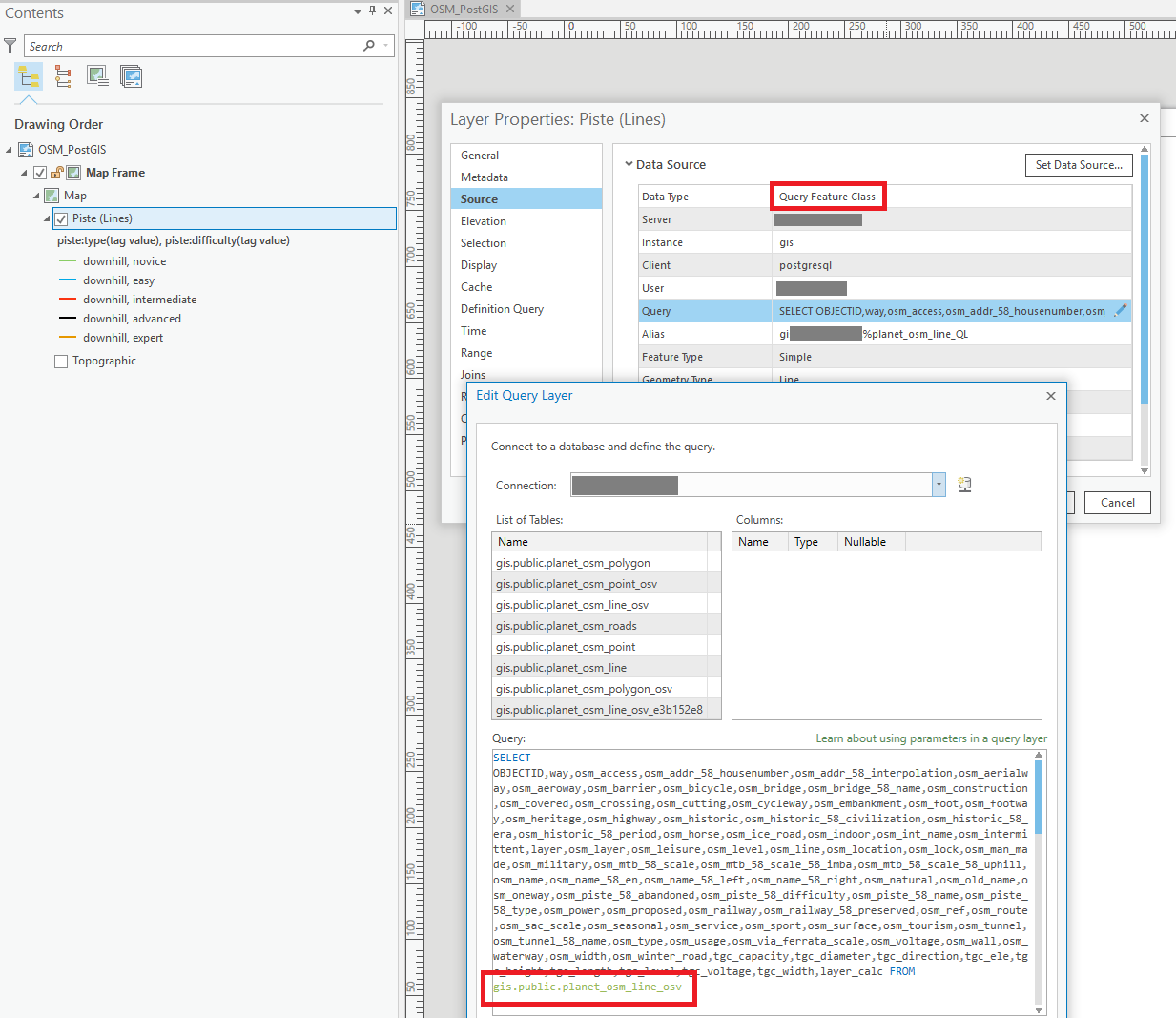

A line layer with a valid Definition Query set present in the TOC. The layer is an ArcGIS Query Layer (so a spatial database but not an enterprise geodatabase) and references a huge Europe OpenStreetMap extract containing +/- 65M records in the line table. This line table has both valid spatial index (GIST) and attribute indexes. The display performance of the layers in Pro's Map window is adequate, and actually surprisingly fast given the huge data source.

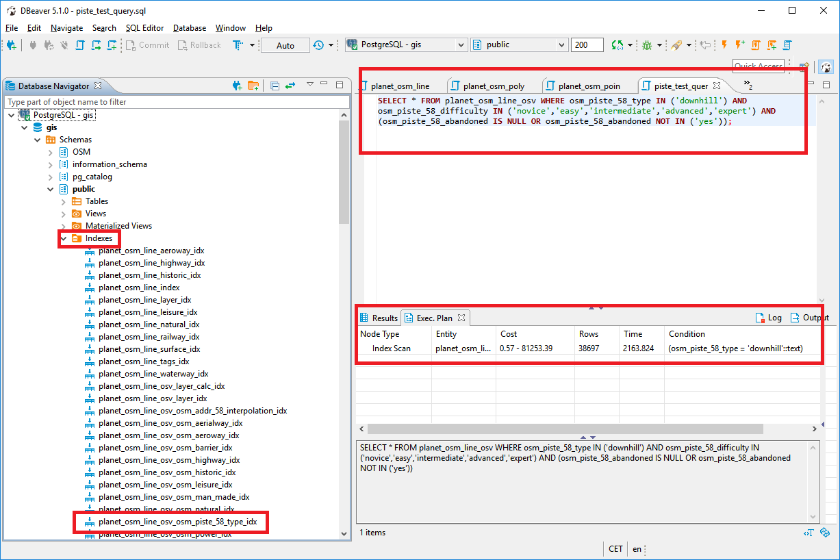

The Definition Query set on the layer, see image, references an indexed field, osm_piste_58_type:
If I insert the Definition Query in DBeaver IDE, and prepend it with the necessary SELECT...FROM... that is missing in the Definition Query itself, and run an execution plan, the query runs in less than 3 seconds (2163ms) and returns 38697 rows, so just under 40k records. The execution plan shows the database correctly using the available index ("Index Scan"):

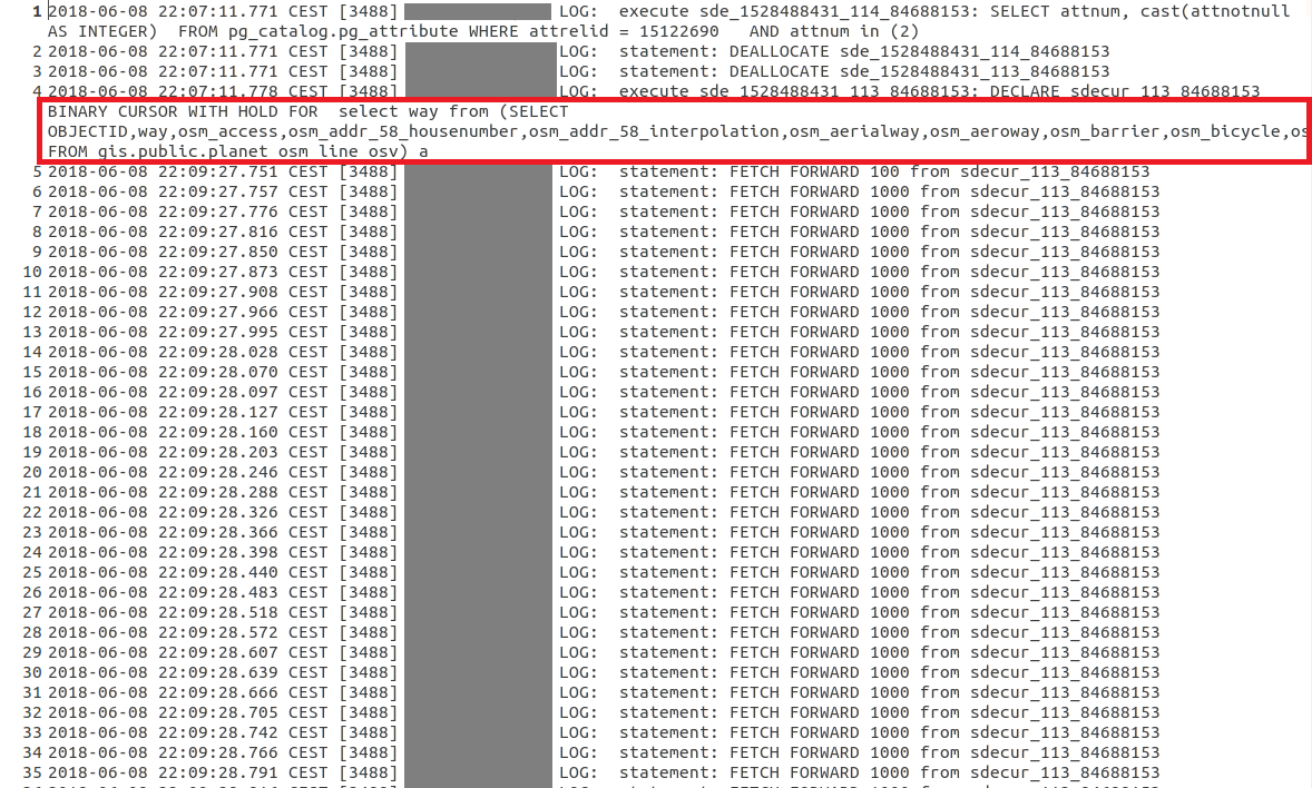

When I enable logging in PostgreSQL and check the created log, I can see the SQL generated the moment I open the attribute table. Much to my surprise, even though the Query Layer had a Definition Query set, this Definition Query is not set on the SQL send to the database to restrict the binary cursor being created, as a consequence, the entire table seems subsequently to start being scanned in chunks of 1000 records, see the FETCH FORWARD 1000 statements in the log. This seems to go on the entire half hour, until a full table scan of all the millions of records is done, and the final table is created. As I wrote above, the final result in the Attribute Table, does correspond to the Definition Query, and is only the 38697 rows.

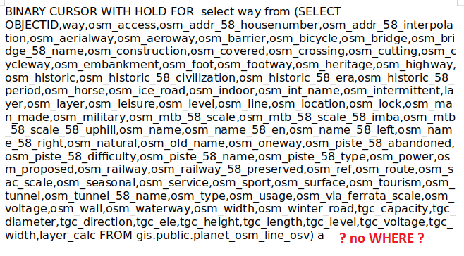

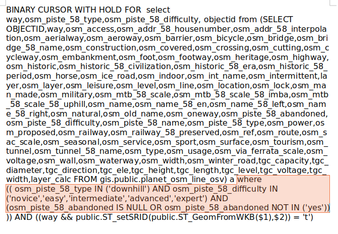

To inspect this better, I copied both the cursor statement that is initially used to create the layer (which is fast!), and compared it with the above statement representing the opening of the Attribute Table in an OpenOffice document, see the below screenshots. Notice how the first screenshot, which represent the moment the layer is created when the Pro Map document is opened and the TOC layer generated, does contain the Definition Query in the WHERE statement. This WHERE statement is omitted though, in the second screenshot that represents the opening of the Attribute Table:
- Creation of Query Layer:
- Opening Attribute Table:
Am I missing something here, or fundamentally misunderstanding what is going on and misinterpreting this data? Why is there no WHERE statement submitted to the database when opening the Attribute Table of a (Query) Layer?

I am now even more confused about what is going on. If you look closely at the first SQL statement that represents the generation of the TOC layer, it appears the required osm_piste_58_abandoned field, that is part of the Definition Query and thus the WHERE clause, is not listed in the field list of the BINARY CURSOR. The other required fields for evaluating the WHERE clause (osm_piste_58_type and osm_piste_58_difficulty) are listed:
The SQL statement thus shouldn't even be valid, yet ArcGIS Pro opens up happily without error and the layer seems OK once I inspect the attributes?...

OK, this particular issue with the apparently missing osm_piste_58_abandoned field seems (partly) false alarm. I don't know if this is actually part of the SQL standards, but it seems PostgreSQL is fault tolerant in this respect, and silently adds the required field to satisfy the WHERE condition. I conclude this based on creating a similar statement in DBeaver, that does return results. Nonetheless, it would be nicer to actually see such field explicitly included in the SQL send to the database, also for consistency reasons, as the osm_piste_58_type and osm_piste_58_difficulty fields that are also part of the WHERE statement, are included as I already stated in the previous post:
Only when I exclude the osm_piste_58_abandoned from the inner SELECT, does it fail:
