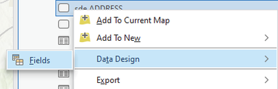

Currently, I would like to setup Subtypes through data design, but this is what I see:

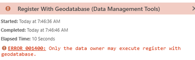

I was curious if it may not be registered with the geodatabase, so I attempted to use the tool:
In the case of transactional replication, who is the data owner, and how can I make these changes? I'm signed in using sa and am the owner of the data itself.
Everything is also read-only:

Based on the screenshot, it looks like SDE is the data owner. You would need to connect as the SDE user to make the changes.
It is also not recommended to have data owned by SDE.
Can you provide some more info if SDE is not the data owner?
Even connecting as SA does not allow you to make some changes within the Pro client.
--- George T.

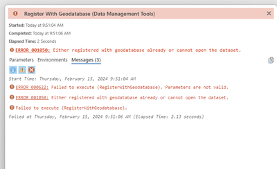

I ended up attempting to connect with SDE and it still referred to me as not the owner. I attempted to create a DBO role and made some more progress, but now I'm facing this:
Maybe some good progress?

I am not sure what would be next, since it seems that the layer is already part of the geodatabase so trying to register it is not a path forward.
Are you sure that the database is already enabled as an Enterprise Geodatabase?
Based on the screenshot at the top, it looks like this is a view?
How was the SDE user created?
