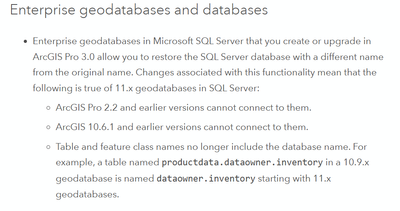

RyanUthoff
MVP Regular Contributor
Oh no, I apologize. It appears this only applies to MS SQL Server EGDBs, at least according to the what's new documentation and this documentation. I thought it applied to all DBs. I'm not 100% sure if it's possible to rename a PostgreSQL EGDB or not. But this functionality was released in Pro 3.0 and Enterprise 11.x.
