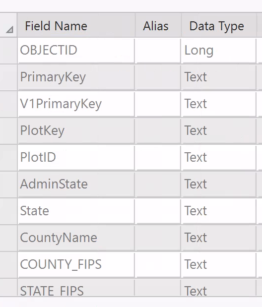

Have a simple view that combines two layers using Union.  SQL server is the SDE backend. Both layers match exactly and have friendly alias field names with spaces.
My view completely dropped the alias values on the view.  There is no way to edit them either.

Views are, well, views. The geodatabase doesn't have the XML metadata from the original table(s)' columns, so it can't know what the aliases were. So it's not a matter of "dropping" them so much as never having had them. And if the view can't participate in geodatabase behaviors, it doesn't get the XML that permits aliases to exist.

I understand but I was hoping when I registered the view with the geodatabase it could pick these up.
