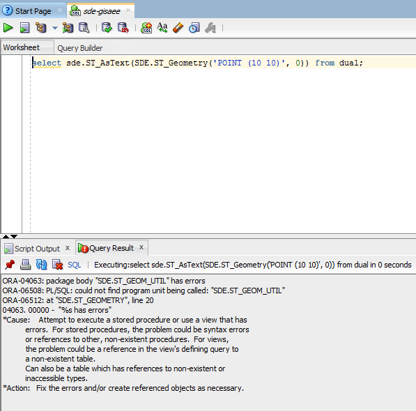

But after running select sde.ST_AsText(SDE.ST_Geometry('POINT (10 10)', 0)) from dual;
My situation with the database is serious.
Thanks for your help!

George_Thompson
Esri Notable Contributor

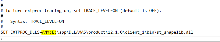

Change the EXPTROC to "ANY" then retry.
--- George T.
DiegoLlamas
Nop, after change to any and recompile, I had the exact same error.

I would update SET EXTPROC_DLLS=ANY and that is all.
You may have corrupted the GDB install with the create spatial type step. I would create a new empty Oracle DB and then just run the Create Enterprise GDB. You will need to update the library path for the new GDB and that should take care of it. No data is needed in the GDB for this part.
