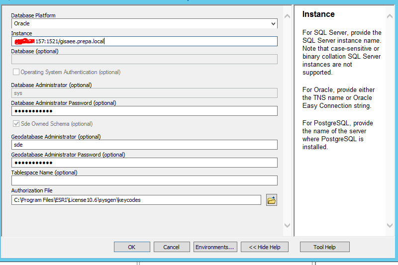

Hello,
I am super new using Oracle and I am having some problems creating a database in oracle. I have installed Oracle (with no database created) I also set the path environment variable in windows server and I am able to access other Oracle DBs already created.
I do not have an oracle database created in this new server Do I need to have one so I can use that name to access it? because I do not have any but I am using the IP:port/the name of the database I want to give to it, is this correct?
This tool is going to create the sys user automatically?
I am getting this error
Is there something I need to do?
Thanks,
Diego Llamas

George_Thompson
Esri Notable Contributor
Yes, create the DB on the Oracle instance before you use that GP tool. You will need the SYS user PW for the EGDB creation.
Then you can use EZConnect for the connection string; i.e ServerName/SID      SID = Oracle DB name
Here are the options: Create a geodatabase in Oracle—Help | ArcGIS Desktop
