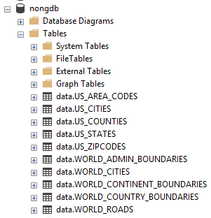

If you connect in SSMS and look at the database, do you see any "DBO / SDE" repository tables?
Specifically, "sde.version" table?
Example of the table:
George_Thompson_0-1743193906774.pngGeorge_Thompson_0-1743193906774.pngGeorge_Thompson_1-1743193917552.pngGeorge_Thompson_1-1743193917552.png
You can load data into a SQL non-geodatabase and it will display and work with Pro with no issues. See my example below:

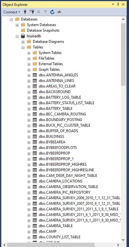

No, it looks like I did something wrong creating the geodatabase in ArcMap/ArcCatelog.  Can you point me to the detailed instructions for that?  I only see my own tables in SSMS attached pictures.
I was under the impression that I could use ArcMap/Catalog to create a workgroup SQL Express database that can be accessed by ArcGIS Pro.  Is that not correct?
