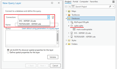

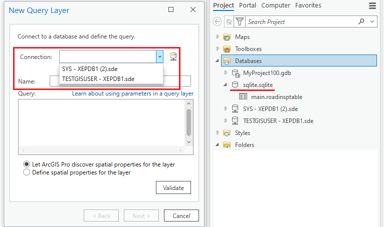

Do SQLite databases really support query layers?
As far as I can tell, the New Query Layer dialog and the Make Query Layer geoprocessing tool only support .sde connections (enterprise database or enterprise geodatabase).
Make Query Layer (Data Management)
Creates a query layer from a DBMS table based on an input SQL select statement.
...Query layers only work with enterprise databases. File geodatabases are not a valid input workspace for this tool.
Are the Add Join docs wrong?
DLowery
Thank you for bringing this to our attention. The geodatabase team has identified this as a limitation and we are working towards an update in a future release.
