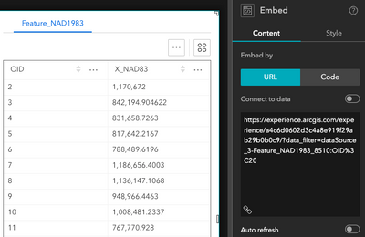

If you would like to make the embedded app to be more flexible, try a dynamic URL - you can replace any value you were using and pass URL parameters from the app URL to the Embed widget at run time to control what appears in the embedded contents. Here's what I tried to do with my configuration:
1. Create a new app and add an Embed widget with a map and a table
2. Copy and paste my app with a filter (here I use dsId:OID<20 as an example). Save the new app, append &exampleParam= to the end of app URL, and refresh the app
3. From Embed widget setting, you will see exampleParam in URL info. It can be added to the embedded URL by clicking on it. You can replace any content with {appURL.search.exampleParam}. Let's say we replace value "20" - now the filter changes to
data_filter=dataSource_3-Feature_NAD1983_8510:OID%3C{appURL.search.exampleParam}

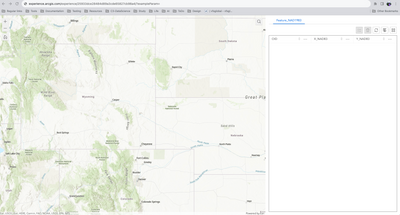

 4. Now save the app, publish and view the app. The app launches with no data in it (as the SQL expression in the Embed widget is incomplete and invalid)

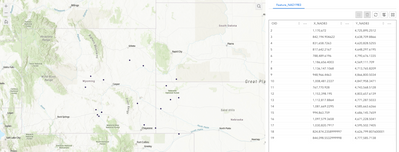

5. Add ?exampleParam=20 to the URL. Now the app displays with the corresponding filter applied.
