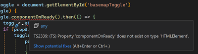

  • TypeScript - Technically, Experience Builder is not written in JavaScript. It's in TypeScript. TypeScript is a superscript of JavaScript that "strictly enforces" typing. (It does not.) Done correctly, TypeScript makes the IntelliSense built into your IDE much better. But Experience Builder typings are frequently wrong, which costs this point it's green text. If IntelliSense gives an error code starting with TS, ignore it and see if it works anyway. It often does.JeffreyThompson2_0-1763409101504.pngJeffreyThompson2_0-1763409101504.png
