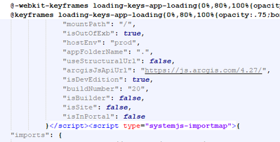

In the folder on your deployment server, you will find four items. One of them is a folder called cdn. The file you want to open is the index.html. Use the Open With option to open it in a code editor. Using Open will try and fail to open the application.
If you're as sloppy as me, this cdn folder will contain a bunch of numbered folders each one representing a built and deployed version of your application.
In the index.html, you will change two numbers to switch between build folders.
On line 1, find this href in the <base />.
On line 80, find the buildNumber attribute.
Subtracting one is a good bet for going back one version. This trick could be useful for maintaining multiple versions of an application for other reasons as well, like getting data from backup sources or seasonal variants.
