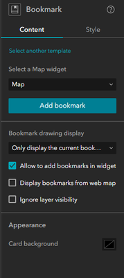

Did you know that bookmarks save the current layer visibility as well as the map extent? They do. And that's really all this trick is. Honestly, I'm not sure this is even a trick. It feels awful close to an intended use case, but not a super obvious one. Or maybe ya'll know this already and I'll look like an idiot for thinking this is remotely clever. I build stuff. I don't use stuff. Builders and users don't always see stuff the same way. We need to see this from both perspectives for this trick to work.
Builder Me
As Builder Me, I will add a Bookmark Widget to my project. I will use that second template on the top row as it will give the best appearance for this usage. I'll turn on Allow To Add Bookmarks In Widget and make sure Ignore Layer Visibility is off.
That's it for set-up. I won't add any of my own bookmarks for this usage.
User Me
I go about doing my job until the clock reads quittin' time. I open up the Bookmark Widget and hit the plus sign. I could rename it if I want. Maybe today's date. Don't have to. Tomorrow, I come into work, hit my bookmark and get back to my job. The end. App state restored.
