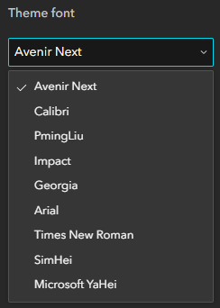

Now, we will pick a font. Here are the choices. If you want to use something else, you will need Developer Edition.
I picked Georgia and here's how it looks.

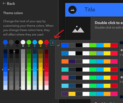

Let's go back to the Advanced color setting option. In this panel, you will see a set of 8 colors colors that are used in the application. Clicking the carrot next to the colors will open an additional menu containing sets of complementary colors that can be used to quickly replace all 8 colors.
The colors from left to right are:
  1. Primary - The main color
  2. Secondary - An accent color. By default, it is never used. You must ask for it.
  3. Dark - The "black" color
  4. Light - The "white" color
  5. Success - Used for messages like "Form received".
  6. Info - Rarely used for messages that are not the other three categories.
  7. Warning - Used for non-critical errors.
  8. Danger - Used for serious alerts like "This will be permanently deleted." and critical errors.
You should keep 3-8 close to their default values. Messing with the Dark and Light values may make your text very hard to read. And users expect the various warnings to be in certain colors. You can set the Secondary color to anything you want. But why bother setting a value that is never used? Because setting the colors of a theme will change the values in the color picker throughout the Builder mode, so you can find it later and use it somewhere else in your application.
My theme colors are the blue I have already set as my Primary color, a red (#e00053) and a silvery-grey (#888b8d). The grey is too dark to be my Light and too light to be my Dark, so I will make it my Secondary color. And the red is very close to the default Danger red, so I will replace that value. (There is no rule against using Danger as an accent color, but be careful not to confuse your users. They may think a red button is dangerous to click.)
