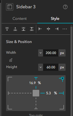

  1. Add a Sidebar Widget. In the Style Tab, switch to px and set the width and height, as you'll get better results if the Sidebar stays a consistent size. You'll want the width to be about equal to the length of text. You want to set the height as low as you can. (This is a design decision. Do you need to display all your options at once or not? How much interactive space can you give up to this menu?) Then add about 20px to your number.JeffreyThompson2_0-1715267250480.pngJeffreyThompson2_0-1715267250480.png

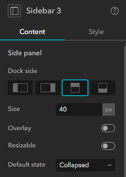

  2. In the Content Tab, set the Dock Side to open down (third choice from left), Size to the number you picked above, Overlay and Resizable to off, and Default State to Collapsed.JeffreyThompson2_1-1715267824987.pngJeffreyThompson2_1-1715267824987.png

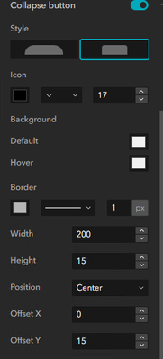

  4. Go back to the Sidebar Settings Panel under the Content Tab and style the collapse button. This part is pretty subjective, so play around with the options till it looks right. I think setting the Style to the more rectangular option looks better for this application. I set the Width to the entire width of my Sidebar and the Position to Center. Using a Width about 1/5th the width of the Sidebar and Position Right is also a good choice.JeffreyThompson2_2-1715270172516.pngJeffreyThompson2_2-1715270172516.png

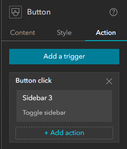

  4. In the Action Tab, select Add A Trigger > Button Click > Your Sidebar > Toggle Sidebar.JeffreyThompson2_5-1715271863546.pngJeffreyThompson2_5-1715271863546.png
