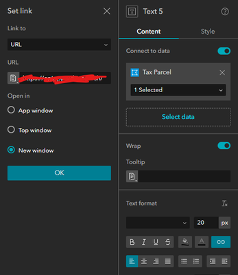

I am trying to build a link to a page on an internal server. It's not exactly formatted like a standard URL. Let's say it looks like, https://internal/site. I can type this into my browser and it works just fine. But when I try to make a link with a Text or Button Widget, I get an error and Experience Builder won't allow me to click OK.
I assume Experience Builder is using regex to validate the address and is rejecting it because it lacks a high level domain, like .com or .org. (If that doesn't make sense to you, don't worry about it.)
So what can I do? Connect my widget to data. What data? It doesn't matter. I'm not going to use it. Now that I am connected to data I get a slightly different Set Link settings panel and this one doesn't reject my non-standard URL. And my link works just fine.
