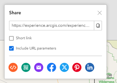

How was I going to get my internet point now? Luckily, I remembered a hack posted by someone on the Product Team. @AlixVezina? You can use the Share Widget to easily figure out URL Parameters for you! Here's how it goes:
  1. Add a Share Widget.
  2. Open up Preview Mode.
  3. Get your map/data set up the way you want it.
  4. Open the Share Widget.
  5. Turn off Short Link and make sure Include URL Parameters are on.
  6. Copy the URL and paste it into a file on your computer.
  7. Delete "?draft=true" from the URL.
  8. Repeat steps 3-7 until you have all the URLs you need.
  9. If you don't want the Share Widget in your final project, you can delete it now.
