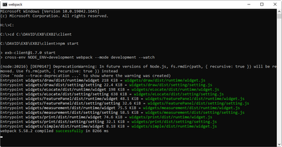

You should receive a message saying:
cross-env NODE_ENV=development webpack --mode development --watch
However, you are getting this message:
'crossw-env' is not recognized as an internal or external command, operable program, or batch file
6.
If everything works correctly, you should have 2 Command Windows open:
