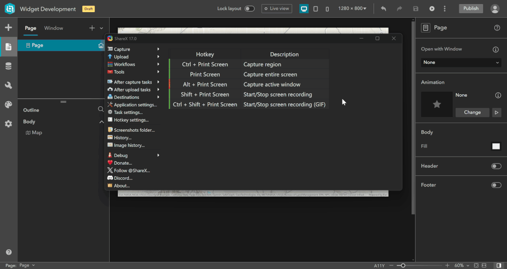

PartyPelican
I have a somewhat working "shell" example, but I am looking for any additional examples on how to create a custom layout widget. I appreciate anyone's help. shell example.gif
https://github.com/Party-Pelican/exb-custom-widgets/tree/main/widgets/shell
