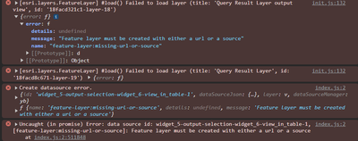

With this, in the table widget I can select Query Result Layer output as data action. However, whenever I try to execute the query I get this error:
I would appreciate any kind of help. Please let me know if you need more info... Thanks!
Note: I tested this with a custom table, everything works as expected.

I have seen that error before trying to create a FeatureLayer on the client-side. FeatureLayers must have either the url property or the source property with any array of Graphic objects.
https://developers.arcgis.com/javascript/latest/api-reference/esri-layers-FeatureLayer.html#source
