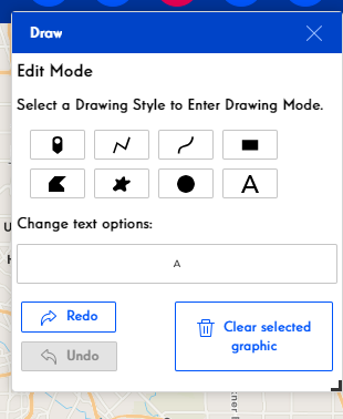

This is a re-designed version the draw widget by @RobertScheitlin__GISP. His draw widget has a number of advantages over the OOTB draw widget including the ability to use text, editing a drawing and more drawing tools. However, the user interface needs some improvement.
This widget has modified his code to improve the overall user experience.
Changes:
  • Many of the internal menus were displaying behind other menus making them difficult or impossible to access. These issues should all be fixed.
  • Text added to clarify if the widget is in draw or edit mode and how to access the other mode.
  • The draw tools have been placed in a flexbox div to make the layout better organized.
  • The options button has been widened and labeled to make it clear that is different than the draw tool buttons.
  • The Undo/Redo buttons will only display if it is possible to undo or redo something.
  • Text in the delete button will clarify if deleting a single or all graphics.
  • Text options menu has been re-ordered and re-designed with additional text to clarify options.
  • Entering text does not require deleting default text.
  • Preview will accurately reflect the map symbol regardless of theme font.
Edited: Undo and Redo buttons should perform correct action.

Awesome! This is going to solve a number of issues we were having with the basic draw widget. Thanks for sharing.
Playing around with the new widget I noticed that the labels on the undo and redo buttons were switched. I made a small change to the widget.tsx to fix.

JeffreyThompson2
MVP Frequent Contributor
Thanks for finding this. It has been fixed.

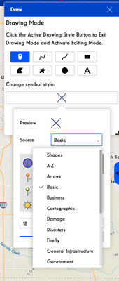

Hi, and thank you for the awesome work.
I was wondering if you could help me with a little customization.
When the "Draw Point" option is selected, in the Symbol Selector there is a "Source" Combobox, where you can select various categories of symbols. Is there a way to add custom categories? With the old custom Draw widget in Web AppBuilder it was quite simple, but in Experience Builder I can't find where these categories are located.
Can you point me in the right direction?
Thank you,
Marco
JeffreyThompson2
The <SymbolSelector/> is located at client/jimu-ui/advanced/lib/map/components/symbol-selector. Tracing this back as far as I can, it appears to call in the graphic options from the API. I don't have a practical way of injecting any custom symbols in this chain. Building your own Draw Widget might be the most practical path forward.
