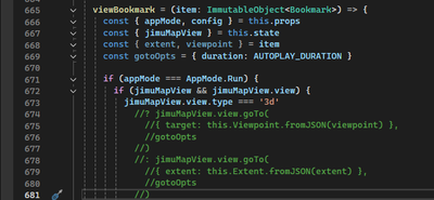

TheRrrr42
Inside of the bookmark widget.tsx you can comment out these lines. Doing so will remove the goTo and result in the bookmark widget just turning layers on and off.
