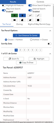

It shows me popup info. That's great. How is it presented?
  • The Search Area is shown with a magenta drawing on the map.
    • Users can hide and turn this on/off with the Show Search Graphics Switch.
  • Data is neatly sorted by layer with Tabs.
    • Builder option to not use Tabs for results.
  • If a large number of results are found in a layer, Pagination is used to further organize data.
    • Builder option for how many results before Pagination is used.
      • Set the number really high if you don't want Pagination.
  • Each individual feature is wrapped in a Collapsable Panel for hiding a result.
    • The panels will not be used if only one result is found in a layer or Pagination is set to 1.
  • Each feature has options to Zoom To it, Highlight it or send it to the Draw Widget with Copy To Draw.
    • Builder option to disable Copy To Draw.
    • Highlighting can also be turned on/off at the layer level with Highlight Layer Button or the all feature level with the Highlight All Features Switch.
      • Note: The Experience Builder framework will also trigger its own highlighting that is not controllable by this Widget.
      • Hovering over a result table will also cause the feature to briefly highlight in yellow.

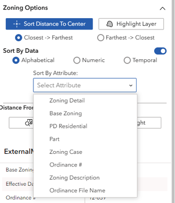

  • Features are default sorted by their proximity to the center of the search area with the distance to center displayed for each feature.
    • User options to sort alphabetically, numerically, or temporally with dropdown menu of appropriate fields.JeffreyThompson2_1-1777660278461.png
    • Builder option to disable sorting.
      • This also hides the Highlight Layer Button.

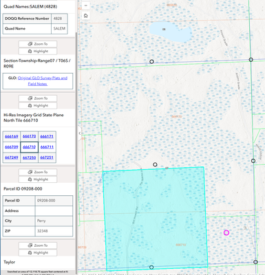

What kind of shapes can I use to Identify with?
Starting in the top row and going left to right the options are:
  • Map Extent - Selects the entire currently visible map extent.
    • Note: This Widget can return an indefinite number of results at a time and it performs well into the hundreds of results. However, somewhere around 500 results the performance dramatically decreases and it will take a long time for results to be returned. Unintuitively, this will also dramatically slow down the next search in the sequence as well.
      • Using this option can easily exceed this threshold, use with caution.
  • Point - This is the default option.
    • A click listener will Identify immediately wherever the map is clicked.
      • The user can turn off this click listener by clicking the Point Button, turning off the Map Click Search Switch, or picking a different draw tool.
    • Builder option to disable this when the Widget loads.
    • By default, the Widget will switch to Point mode after some other shape is used.
      • Turning off Map Click Search will disable this behavior.
        • This is how the Map Click Search Switch and Point Buttons differ. Allowing users to draw a shape without fear of accidentally triggering a Point search.
      • Builders can hide this Switch, if not wanted.
    • Note: Points are not points. They are circles that are really 60-sided polygons. It is practically impossible to use a point to find another point or line feature. This is why the standard hitTest() function uses a 6 pixel buffer around the actual clicked point. This Widget mimics this behavior by using a buffer that is some percentage of the width of the screen.
      • Builder option for controlling the percentage this buffer represents.
      • The default is 0.005. This is a bit larger than the hitTest() standard, but much smaller it becomes very difficult to identify points.
  • Polyline
  • Freehand Polyline
  • Rectangle- First option on second line.
  • Polygon
  • Freehand Polygon
  • Circle - Not a true circle. It's a 60-sided polygon.

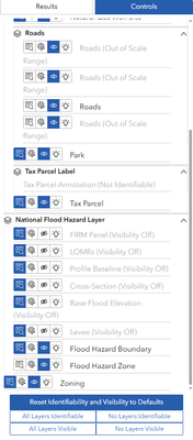

What's this Controls Tab for?
This is my version of a Map Layers List. Every operational layer and sublayer that does not have the listMode = 'hide' property is listed in this sub-widget.
  • Sublayers are listed in Collapsable Panels.
  • This list will adapt to map changes.
  • Identifiable layers are labeled in black.
  • Layers that cannot currently be identified are labelled in light grey with a reason why Identify won't work on them.
  • Each layer has four buttons from left to right they are:
    • Identify - Turns on/off identify for this layer.
    • Exclusive Identify
      • Turns on Identify for this layer and turns it off for all other layers.
      • Turning this feature off should reset the identify settings as they were before it was turned on.
    • Visibility - Turns on/off visibility for this layer.
    • Exclusive Visibility - Like the Exclusive Identify, but toggles visibility.
  • There are five additional buttons at the bottom. They are:
    • Reset Identifiability and Visibility to Defaults
      • When a layer is first loaded into the map, this Widget will save its popupEnabled and visibility state. Clicking this button will instantly reset every map layer to its initial states.
    • The other four buttons are intended to be used when only a few layers are supposed to be or not be visible or identifiable. Click one of these then the individual layer buttons.
      • All Layers Identifiable
      • All Layers Visible
      • No Layers Identifiable

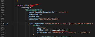

I have encountered an issue where this Widget will sometimes crash out showing a Version Mismatch warning and throwing a Unable to convert from an angular to linear unit error in the console while getting data from an OOTB Widget. I believe this caused by a race condition where the data is not fully written to memory before the layerGroup.tsx logic runs. I am testing a fix where I have replaced the result useEffect in layerGroup.tsx with the two following functions.
    const prepResults = () => {
        geographicSort()
        const startingFields = result.layer.fields
        const time = []
        const num = []
        const alpha = []
        startingFields.forEach(field => {
            const type = field.type
            if (type === 'string') {
                alpha.push(field)
            } else if (type === 'small-integer' || type === 'integer' || type === 'double' || type === 'long' || type === 'oid' || type === 'big-integer') {
                num.push(field)
            } else if (type === 'date' || type === 'date-only' || type === 'time-only') {
                time.push(field)
            setTimeFields(time)
            setNumFields(num)
            setAlphaFields(alpha)
    useEffect(() => {
        let attempts = 0

shodge_fsu
@JeffreyThompson2
Thank you for continuing to share your work so the rest of us don't have to start from scratch.
In my popups I use some basic html to put a background color and style on the headers for the visual effect of separation if you have the tabs turned off.  This worked fine in the previous version of this tool, but now it seems to be ignored (along with the layer name not being displayed in the non-tabbed version.  Was this by design or just something you don't typically use?
I will also point out that sometimes when you click the map, what gets highlighted is not always where you clicked.  I noticed this most when dealing with my parcel layer.  What gets highlighted may be several parcels away.  when I use the highlight tool in the identify panel, it finds the correct ones though.  I need to test some more on this, because it is not always consistently wrong, so I am looking farther into this one.
Again, thanks for contributions.
(here is an example of the parcel highlight issue. [I did edit your code to hide some of the counts and distance stuff])
JeffreyThompson2
MVP Frequent Contributor
@shodge_fsu Personally, I use the Tabbed presentation and very few of the layers I deal with have any Popup customization, so I haven't seen or tested the issue you are describing. This Widget is built on top of the Feature Component and should respect any styling done to a Popup. If the Popup styling is not working, I'd start looking for answers with this post. https://community.esri.com/t5/arcgis-javascript-maps-sdk-questions/4-28-popup-styling-not-working/td...
In an earlier draft of this Widget, I had a heading for title in the non-tabbed presentation. I took it out after adding the sorting options and finding that they provided the required break and labeling for the layer level. If you would like to add a heading back in, the best place to do so would most likely be on the layerGroup.tsx inserting the heading between line 166 and 167.
The Experience Builder framework also generates highlights for Selected Features. These highlights look the same as the highlights generated by this Widget, but aren't always highlighting the same things. I suspect the issue you are describing is caused by this confusion. I don't like this part of the overall UI, but I don't know how to disable the framework generated highlights and, even if I did, I wouldn't because I don't want to interfere with how the framework generally operates.
shodge_fsu
@JeffreyThompson2
I solved the style issue with the title by getting rid of the title and adding a <caption> to the table the pop-up uses for the layer.  Not sure why the title styling doesn't work, but this strategy is simple enough to implement.
I understand your not wanting to mess with EB's highlighting code.  That certainly would complicate things, especially with each new release.  The "wrongly" highlighted featues will be confusing to the users so I am going to see if there is some kind of work around for this.  Will get back to you if I discover anything.
