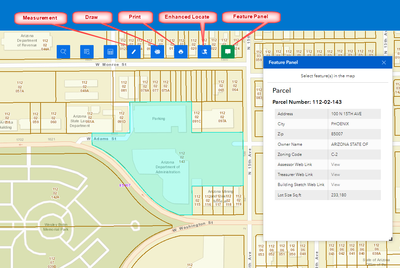

DavidDas__GISP
Hi Robert,
Thanks a million for the Feature Panel Widget!
This was the perfect solution to keep the default Web Map Popup from blocking the full view of the Parcel.
I like the fact that the Feature Panel Widget can be resized and moved anywhere on the map.
Must use Firefox to open this link:
http://www.davidapps.net/exb/ParcelMapV6/

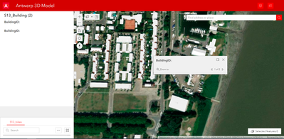

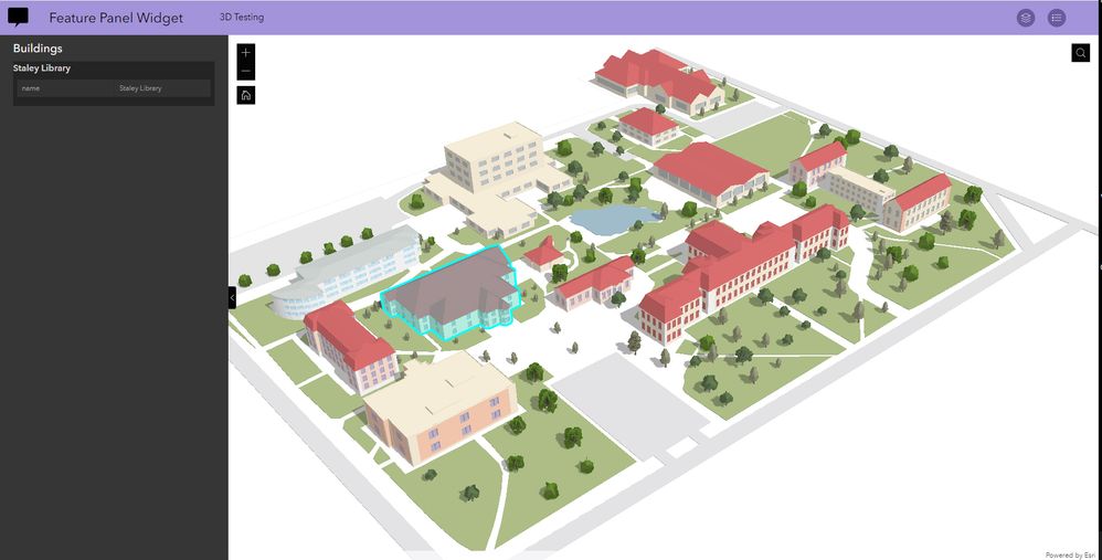

I’m trying to work with the feature panel widget in Experience Builder 1.9 (developer edition) with a scene layer (3D). But, I’m facing some problems. The view of two attribute tables in the feature panel isn’t working right. If I click on two 3D buildings, I get this in the feature panel:
So no attribute table shows up as it should be concatenating the results.
Secondly, I was wondering how I can highlight the selected 3D building like it does with the selection widget. Now, if I click on a 3D building, it doesn’t highlight so the user could not know which building he/she clicked.
Lastly, I was wondering if there is a way to make the feature panel pop up when using the search widget. What I mean by this: instead of clicking on a building here, the user types an address in the upper right corner (on the search widget). Once a search is done, the feature panel should open. Is this possible u think?

@VictoriaJadot  I have done any testing in 3D. Are there any errors shown in your web browsers web console?

@VictoriaJadot So I just did some testing in a web scene and had no issues using this widget when the clicked layer has a popup enabled/configured (and buildings are highlighted). I can see from your image that you still have the scene views popup enabled (and it shows not fields, so that leads me to wonder if your buildings layer has popups configured). In this widgets settings you are cautioned to disable the views popups unless you want the views popup on the map and this widgets panel to show the same data.
VictoriaJadot
@RobertScheitlin__GISP Thank you for the quick reply! I just figured out why my 3D building wasn't highlighting. The layer was published as Shapefile Feature Class. Once i changed this to a File Geodatabase Feature Class, the widget works perfect! The first two problems I encountered have been solved by this, great! I also disabled the  scene views popup as you suggested which is indeed much better.
For the last part, do you know how to make the feature panel work with the search widget?

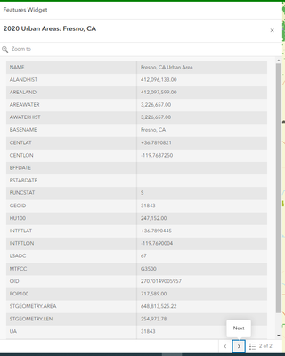

@LefterisKoumis This widget does not have a previous or next record controls. It is different from the popup panel widget in WAB. The feature panel widget just concatenates multiple records in the widget. You just scroll down to see the next feature.

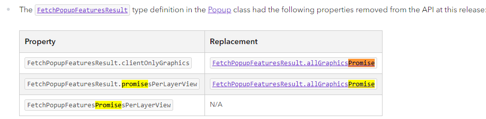

I think with the new release of the 1.14 developers edition on March 19, 2024 there is a problem with this widget (oh the perils of custom code).  The widget blows up looking at this line of code:
this.setState({totalNumOfLayers: response.promisesPerLayerView.length - 1})
there isn't a promisesPerLayerView in the response.  There is however a pendingFeatures that may work.  Not sure how to fix it yet but and still looking and will update this if I make progress.
Here is a hint: From the 4.29 release notes (https://developers.arcgis.com/javascript/latest/release-notes/) I found this:

@shodge_fsu From what I have read it looks like all you need to do is find all of the references to promisesPerLayerView and replace them with allGraphicsPromise. Just replace one name for the other in the setState line and the forEach line just under it. I have not upgraded yet so I cannot test.
shodge_fsu
Unfortunately it is not that simple.  Tried that and a few other variations with no luck.

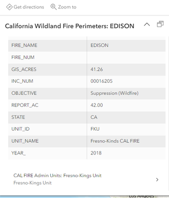

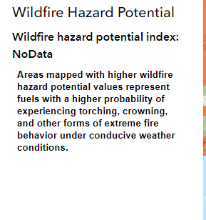

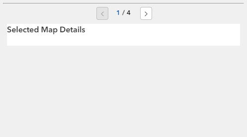

I've tried to use this and extend it to work with the Pagination component from the Jimu component library. From the code below, my selection is generated from response by querying DataSources configured in my widget. In my UI, I get back the proper pop-up title (Selected Map Details), but no attributes even though they all exist within each feature in the selection.
Any ideas where the rest of the popup content is?
