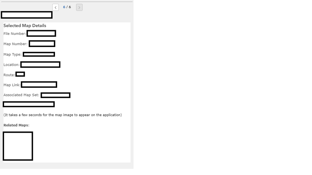

For future reference, the ExB documentation (https://developers.arcgis.com/experience-builder/guide/use-data-source-in-widget/#use-featurelayer) suggests to use the FeatureLayerDataSource and the getPopupInfo method. That method isn't documented in the API Reference section, but getting into the type definition, there is no content property.
I had to set that manually from the description.
        selectedFeature.popupTemplate.content = selectedFeature.popupTemplate.description;
        const graphic = new Graphic({
          geometry: selectedFeature.geometry,
          attributes: selectedFeature.attributes,
          popupTemplate: selectedFeature.popupTemplate
