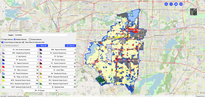

Fancy Filter is designed to take a FeatureLayer with a UniqueValueRenderer and make a set of filters with the legend swatches. The end result is you can make a Filter that also works as a Legend. Imagine making a Zoning map application that looks like this.

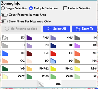

Fancy Filter - This is the original flavor. It is designed to filter a single layer, pre-loaded in the Builder. It can (probably) be used without a Map Widget, although some features do require one. It looks like this:
Fancy Filter Runtime - The earlier picture was from Fancy Filter Runtime. I kind of made this Widget by accident. See I was always planning to build on top of Fancy Filter and before I released it to the public I wanted to do a test to see if I could select the DataSource at runtime and pass it into Fancy Filter, in case, I needed to make any modifications to Fancy Filter to accommodate getting the DataSource differently. (Turns out I did. So, good choice me.) Turns out that getting the DataSource at runtime was a challenge maybe more difficult than the original Fancy Filter.
