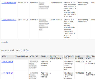

We are in the VERY early stages of looking at moving our JS site into a Experience Builder site.  In this site I wrote a ID Results windows that replicated the even older ArcIMS window,  See below.  This goes through the results object and builds tables for each layer's results.  This is crucial for us as when you click on a location you need to see all results at once.  Paging through them isn't an option.  We need to scan down the list to see which is relevant  - there could be scores of hits on any single location. (I was going to add the results into a dojo sortable table, but never got around to it, so these are just in  an HTML table)
Before we embark on writing something, is there anything already out there?
