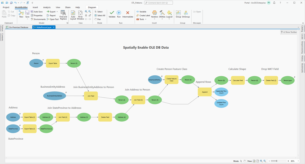

In the ModelBuilder session below, I am ingesting normalized data from a Microsoft Access connection into an ArcGIS Pro project geodatabase, including spatially enabling a column storing well-known-text (WKT) geometry.   Four tables are joined to create the desired output information product for GIS mapping and analysis.  The result can be refreshed on demand should the source data change.
ETL of OLE DB data into geodatabaseETL of OLE DB data into geodatabase
Of course, if your work is supported by simply reading an OLE DB source, you don't need any ETL steps at all!  I'm just demonstrating using a core tool - ModelBuilder - for some typical tasks.

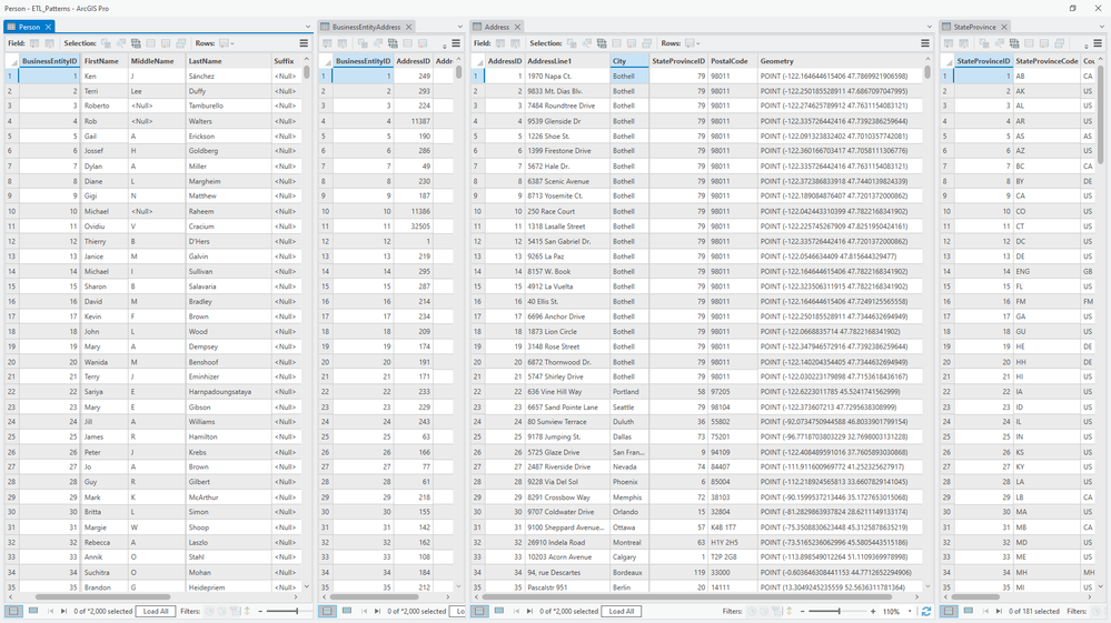

Here are my tables read from Microsoft Access, they are joined Person->BusinessEntityAddress->Address->StateProvince.
OLE DB tables from AccessOLE DB tables from Access
After joining and creation of geometry the data is mapped!  Note the data is fake, it's the venerable AdventureWorks data from Microsoft, created for tutorial purposes (but not included in the blog download), there aren't really cyclists floating in the middle of Port Phillip Bay in Victoria, Australia!
Person table, spatially enabledPerson table, spatially enabled
