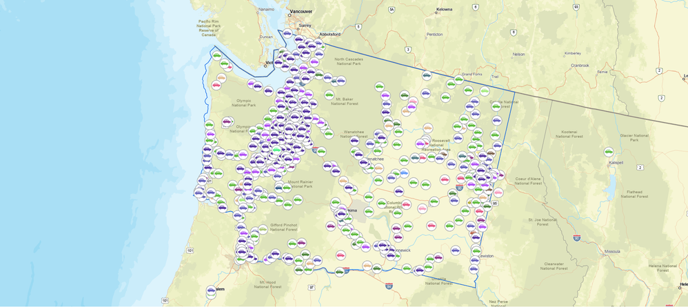

First, the data as a map:
Washington EV PopulationWashington EV Population

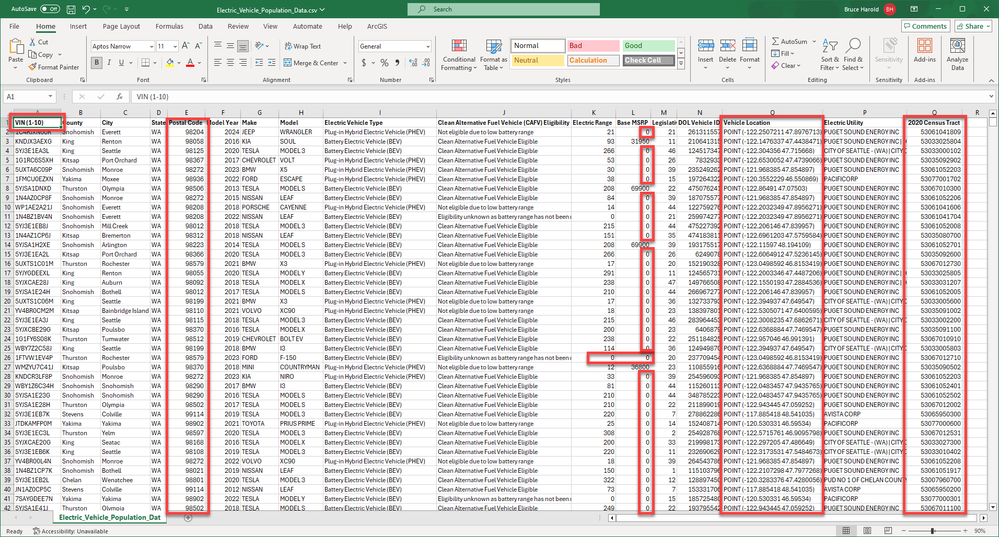

Now the source CSV file:
CSV or Excel Data IssuesCSV or Excel Data Issues
In red I'm picking out some of these usual suspect violations.  Column names have spaces or metacharacters, USPS postcodes can have leading zeros so should be text, zeroes have been used to encode nulls in Electric Range and Base MSRP columns, Vehicle Location is in WKT format and 2020 Census Tract has big integers and a name beginning with a number.

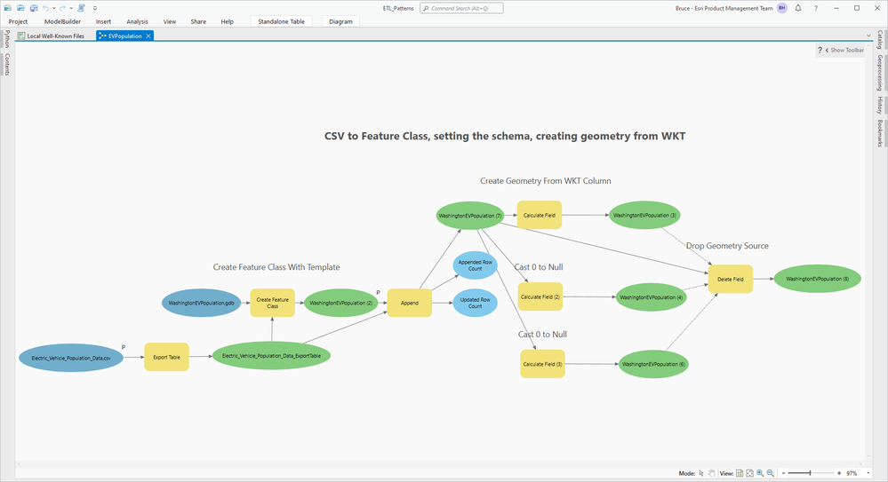

I'm now in a position to design a schema that correctly handles the subject matter file.  I chose ModelBuilder to persist my processing as it can wrap core geoprocessing and Python functions I plan to use.  The finished model is this, which we'll walk through.
EVPopulation ModelEVPopulation Model

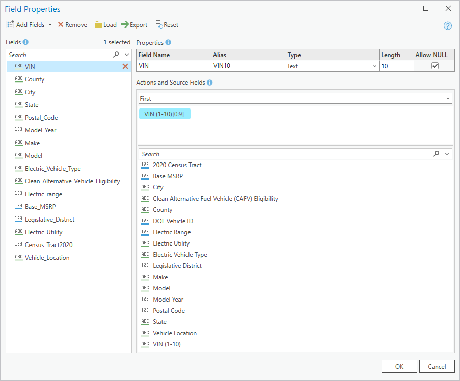

The first order of business is to impose a designed schema.  This is done using the field map control in Export Table, basically copying the data into an in-memory table in the schema you want.  The Field Map control lets you rename, cast and even construct fields very flexibly.
In this case there is only one source field for each output field, so the Action is always First, and only the field properties are manipulated.
Field MapField Map
Downstream of Export Table the output feature class is created using the in-memory table as a template, rows (still with no geometry) are appended to it, then geometry is created from the WKT column and the two fields with zero-encoded nulls are fixed with Calculate Field tools (note the conditional processing).  Lastly, the Vehicle Location field is dropped as surplus to requirements.

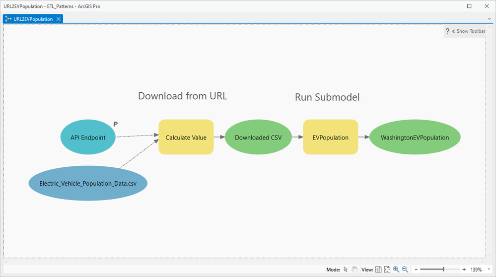

The URL used for file download isn't valid as a geoprocessing Text File input like the model wants. There is also a risk that a user might use an input CSV file of a different name than Electric_Vehicle_Population_Data.csv, which would trigger the field map in Export Table to revert to default field handling, undoing all our schema design work.

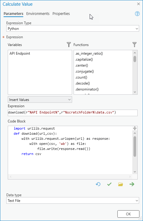

To handle both web data input and consistent file name input the model EVPopulation is wrapped in a parent model, URL2EVPopulation:
URL2EVPopulationURL2EVPopulationWeb DownloadWeb Download
First a Calculate Value model tool downloads the current data to a consistently named file of Text File parameter type, then the EVPopulation model is called to process the data.  See how a very simple Python snippet takes care of automation? 😉
