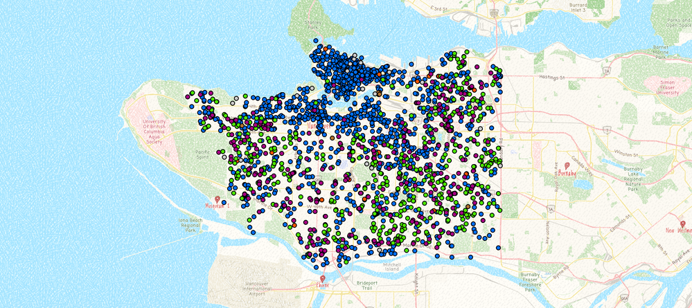

The small dataset first:
Vancouver building permitsVancouver building permits

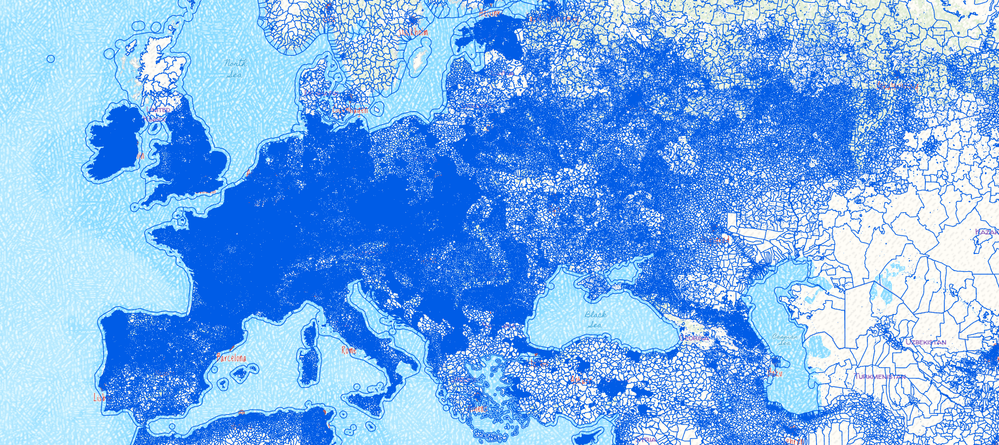

The big dataset:
Worldwide political divisionsWorldwide political divisions
And in the middle ground, the political divisions for just Germany:
A view of political divisions for GermanyA view of political divisions for Germany
All these datasets were ingested similarly but with noteworthy differences we'll discuss below.

Let's see how to tackle the smaller dataset first - building permits, by automated download from a website.
The data resides in an open data portal, if you surf the site you'll see download format options.
The data is automated in the notebook VancouverBuildingPermits.  If you inspect the code you'll note I'm using DuckDB to help out - it is a spatially enabled SQL database and web client.  You'll see the data download and conversion to feature class is very simple - the tooling infers the schema from the Parquet source plus SQL statements.
