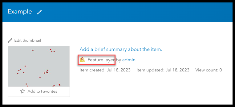

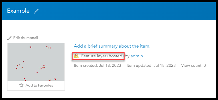

Feature layer vs. hosted feature layer
Feature layerFeature layer
Hosted Feature layerHosted Feature layer
The top image shows the same Feature layer from the previous pair. The bottom image is a different kind of Feature layer, called a hosted feature layer. Both types of Feature layer support editing, but the underlying technology that enables each type is different.
The data for a hosted feature layer must be copied into ArcGIS. The data for a non-hosted feature layer can be in a user-managed data store, like an enterprise geodatabase. The advantage of hosted feature layers is that they use less server memory than a non-hosted feature layer. One advantage of a non-hosted feature layer is that you can use advanced database features like versioning and topology. You also have more control over configuring non-hosted feature layers, but that control comes with more responsibility for configuring them correctly.
Hosted feature layers are available in both ArcGIS Online and ArcGIS Enterprise. Non-hosted feature layers are available only in ArcGIS Enterprise.

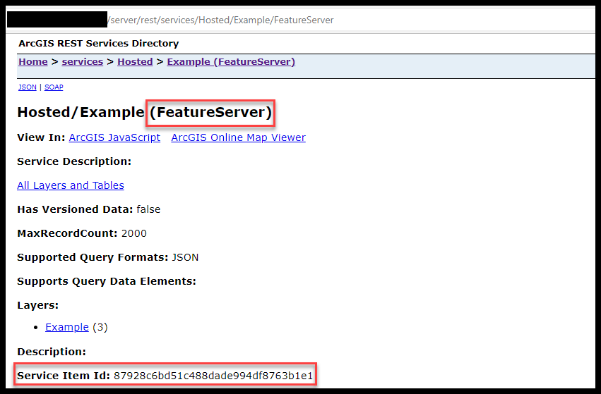

Feature layer vs. feature service
Hosted feature layer with URLHosted feature layer with URL
Feature service with Service Item IdFeature service with Service Item Id
These images look so radically different that the real challenge might be finding ways they are similar. The top image is for the same hosted feature layer item in the previous pair. The bottom image is for the feature service for that hosted feature layer item. You can tell the two are related because the Service Item Id in the bottom image matches the id value in the URL in the top image.
A service defines a set of capabilities. You may have heard people talk about a “REST endpoint”, which refers to the service’s URL used to access those capabilities. You can see some of the service’s capabilities in the bottom image: it is not versioned, it can be queried, it returns a maximum of 2000 records for a single query.
