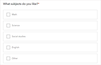

Survey123 allows you to ask multiple select questions, where the person can choose any number of the answer choices. For example, think about questions where, when presented with a list of choices, the same person can have multiple choices that are correct.
  • What subjects do you like?
  • Which of these medicines are you allergic to?
  • Which of these places have you visited?
  • What kind of books do you like to read?
However, in Survey123, multiple select questions record the answer as a string. Specifically, a comma-delimited string where each choice is listed and separated by a comma from the next choice. If you look at these anywhere other than Survey123, you’ll see either:

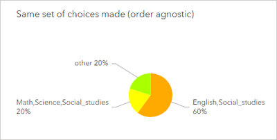

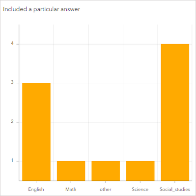

Of course, you can just use the string answer as it is. But be aware that some answers you might consider the same will be used separately. You’ll get charts like this:
Notice that "English,Social_studies" is considered a different answer than "Social_studies,English" – the order the choices are listed impacts if they are considered the same answer.

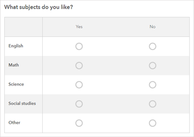

A better way to avoid processing the data is to avoid multiple select questions – and in fact, I recommend that to people new to Survey123 and dashboards. Instead, ask about each subject separately. A recommendation for doing so is to use a single select grid. Ask your question, like "What subjects do you like?" and have a row for each subject in the grid. The reader does have to answer each row, but each answer is stored in its own field.

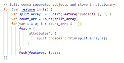

ArcGIS Dashboards have a functionality called "data expressions" – these take data and process it through ArcGIS Arcade into a new dataset that can be used in the dashboard. Data expressions are useful for answering both questions A and B – who gave an answer at all, and who made the same set of choices.
Caption: Snippet of the data expression code for looking at subjects
Data expressions are an advanced technique – they are written in ArcGIS Arcade and require programming ability (or at least the ability to find an example and edit it). In addition, when using data expressions, you work with a FeatureSet in the Dashboard. Think of the feature set as a new set of data – it doesn’t know the full details of your original data. As such, you lose the connection to the exact datapoint on the map. You can see that, for example, 60% of people choose English and Social studies. But you can’t use that information to filter the map and see where those people are.
To use a data expression to parse a multiselect answer, see the data expression example Split comma separated values across multiple rows.

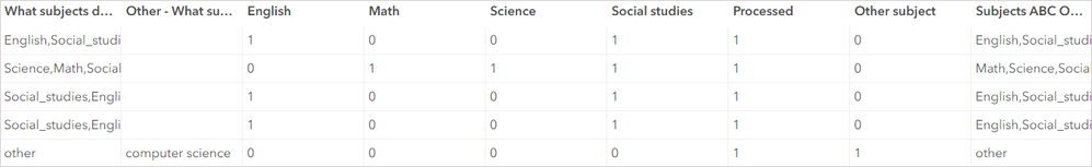

You can present the user with a multi-choice question, and then behind the scenes change what is stored to an attribute per answer. For example, you can alphabetize the choices in the string so that the same answer sets generate the same strings, or you can store the answer to each choice as a yes/no.
There are a few ways you can edit your layer to have additional information also included in it:
  1. Using a notebook in ArcGIS (example notebook)
  2. Through a webhook that parses the data and updates the layer (using Microsoft Power Automate or Make.com)
  3. With calculations in the survey itself (requires Survey123 Connect; see “Controlling how user selections are stored in ArcGIS” in the blog Understanding Multiple-Choice Questions in Survey123 for ArcGIS)
This results in growing the size of your database – for example, you might add a column for each choice in the multiselect to make it easier to see who picked which answers. Have 3 options? That’s 3 more columns. Have 12? That’s 12 more columns. And if you have multiple multiselect questions, you can see how this can quickly grow. (However, it will be the same number of columns you would have if you chose to use a single select grid instead of a multiple select question.)
Unlike data expressions, since you keep the details of the answer tied to the same feature, you retain the connection between the feature and the answer. Since the processed answers are just part of the data, you can even symbolize on the added fields.
