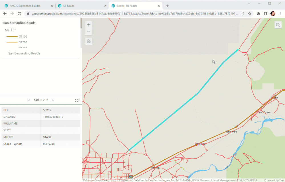

In my example – I have a basic web application showing the street network of San Bernardino County. The app works, but I also want the ability to send users to specific street segments when the app opens. So… how can I do it without the ‘zoom’ url parameter?
Here is the link to my app – feel free to play around with the parameters/URL as well: https://experience.arcgis.com/experience/29285b535d614faaa60b599fc111d775/

But if I want to drive users to a specific feature at the zoom scale I pre-defined, I need to use the other page that I created along with the details of the specific feature. For my app, the data, and my feature, that would look something like this:
https://experience.arcgis.com/experience/29285b535d614faaa60b599fc111d775/page/Zoom?data_id=3b8b7d77...
If I want to change the feature that gets selected in the map, I can modify it manually, or you could do this programmatically as well. If you want to play with it manually, just modify the last characters in the URL following the ‘A’ character. This is the ObjectID for the feature.
For example, take the URL: https://experience.arcgis.com/experience/29285b535d614faaa60b599fc111d775/page/Zoom?data_id=3b8b7d77...
Then replace ‘50965’ at the end of the URL string with ‘50089’, ‘32219’, or try any number!

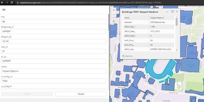

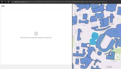

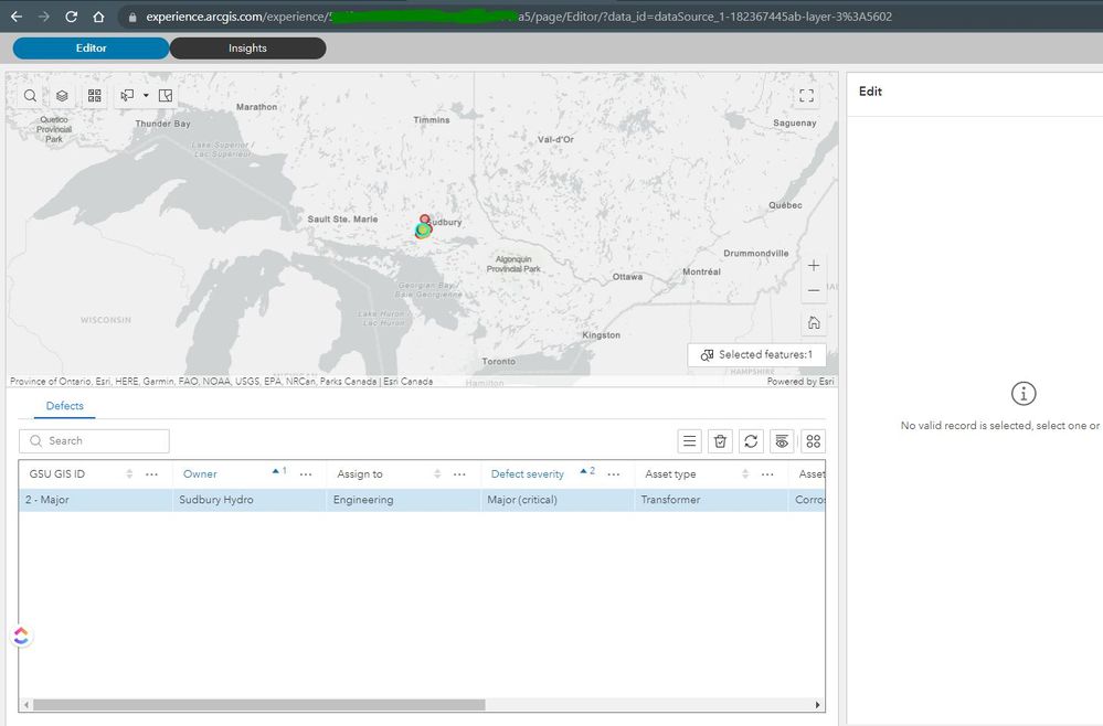

Have you been able to get this to work with editing widget? In my app, when I pass the id in, it selects but it does NOT trigger a zoom. It does select the feature on the map and in table but does NOT trigger a change on the Edit or other widgets on the page.
It's sorta half working. Is there something I need to config in Web Experience Builder itself?
Maybe I'm missing data actions and bindings on the map widget or something?
BrianBaldwin
@PaulGiroux1  - I finally got around to testing this and I am seeing the same thing. In my test - if I 'click' on the feature to cause a 'pop-up' action to take place - it will then pass that over to the Edit widget as a selection - as expected.
Yet - if I use that same 'selected feature' URL - it will not recognize the feature as selected - even though it's highlighted.
Is this the expected behaviour @Jianxia?

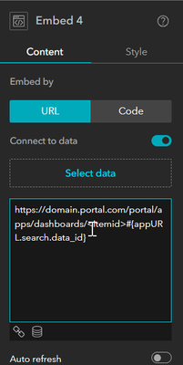

I am using the embed widget in Experience Builder to embed an ArcGIS Dashboard.
I want to pass the currently filtered feature layer in the ExpB app to the embedded dashboard as a url parameter.
I will do this by passing in the ExpB url parameter currently in the browser url like this in the embed widget:
https://domain.portal.com/portal/apps/dashboards/<itemid>#{appURL.search.data_id}

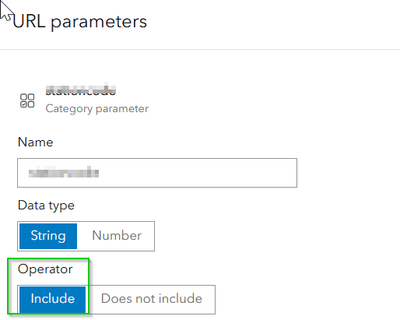

But first, since ArcGIS Dashboards seem to only allow string url parameters, I will need to add a string column to my table/FC, and copy over the OBJECTID values to it.
This way, it will be able to accept the data_id from ExpB.
My question is:
How can we remove/trim the layer's data source ID from the selectedrecordID in the dynamic variable {appURL.search.data_id}.
I only need the selectedrecordID (aka OBJECTID) to pass into the Dashboard.
For example, if the
data_id=dataSource_1-18a09b4c047-layer-12%3A345
I would only need the 345 string to pass into the dashboard.

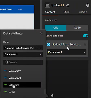

As a follow up to my approach mentioned above:

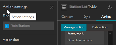

I will control the embedded dashboard by user interaction with a widget that has a configurable action.
For example, the data-centric table widget has a configurable action:
We can add a 'Framework' to either Filter or Select data records.
Select the data the widget will use, aka the 'trigger data'.
Select the 'Action data' that will be filtered/selected based on user interaction with the table widget.

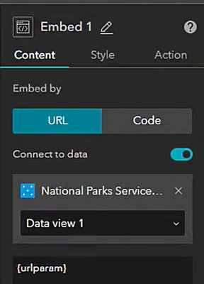

Now for the second widget, which is the embed widget:
Connect to the same dataset the is configured with the table widget's 'Action Data'.
Be consistent in both widgets, whether 'default', or 'selected features' is selected.
Select a column (using the database icon) in that data set that has a string of the desired url parameter in each record, such as:
https://domain.arcgis.com/portal/apps/dashboards/<itemid>#<urlparamcolumn>=<columnvalue>
The url parameter column will appear as such:
Summary:
The table widget will be interacted by users.
For example, a record is selected.
The actions filters that same datasource.
The embed widget connects to that filtered datasource, and renders the filtered record using the url parameter column.
