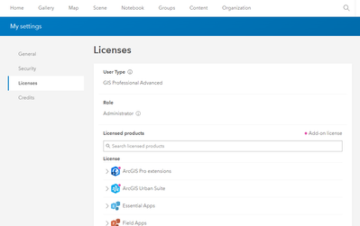

1) If you weren't able to 'save' any of those old projects in ArcGIS Pro 3, then you could just remove ArcGIS Pro 3 and then reinstall 2.X. In your ArcGIS Online settings pane - you can download older versions of Pro (My Settings, Licenses, then scroll down and find ArcGIS Pro)
