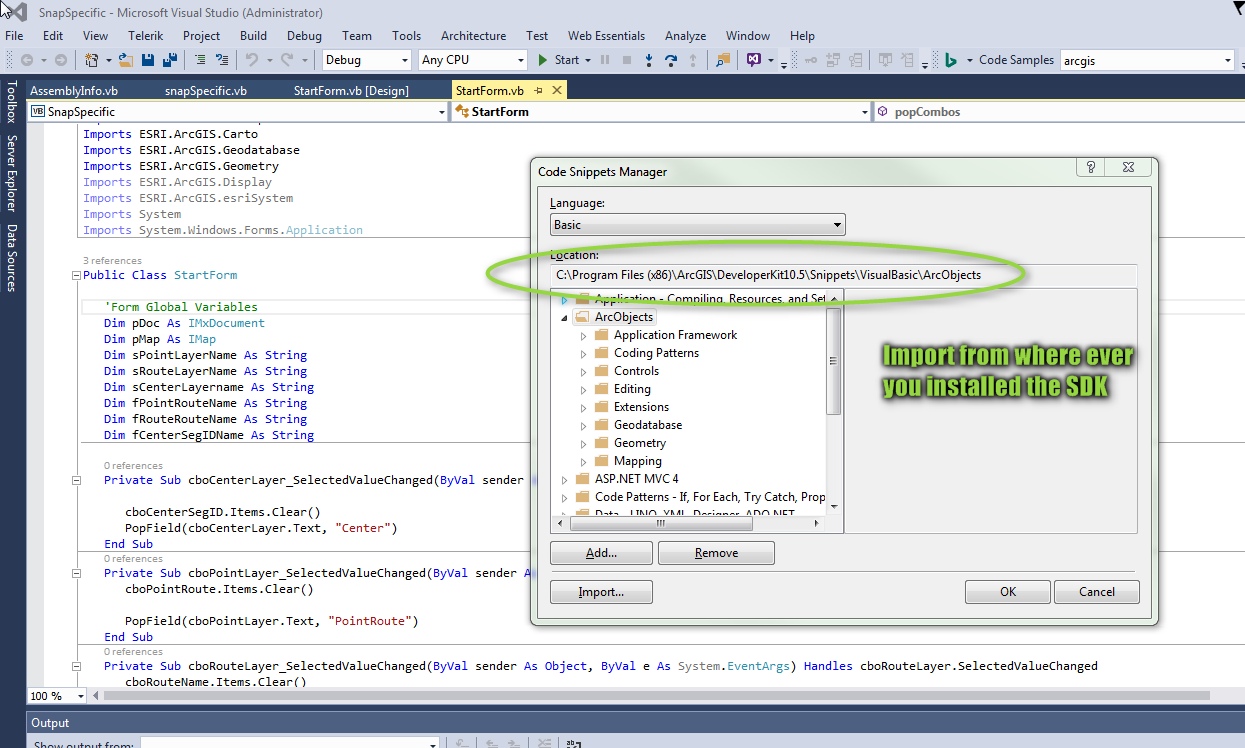

Perhaps you may find it here?   In VS studio either choose from the main menu Tools->Snippet Manager  or it CTRL-B
CharlesBailey3
OK, I got it, so there is no search function in this version. Guess I have to get out my ArcObjects poster...

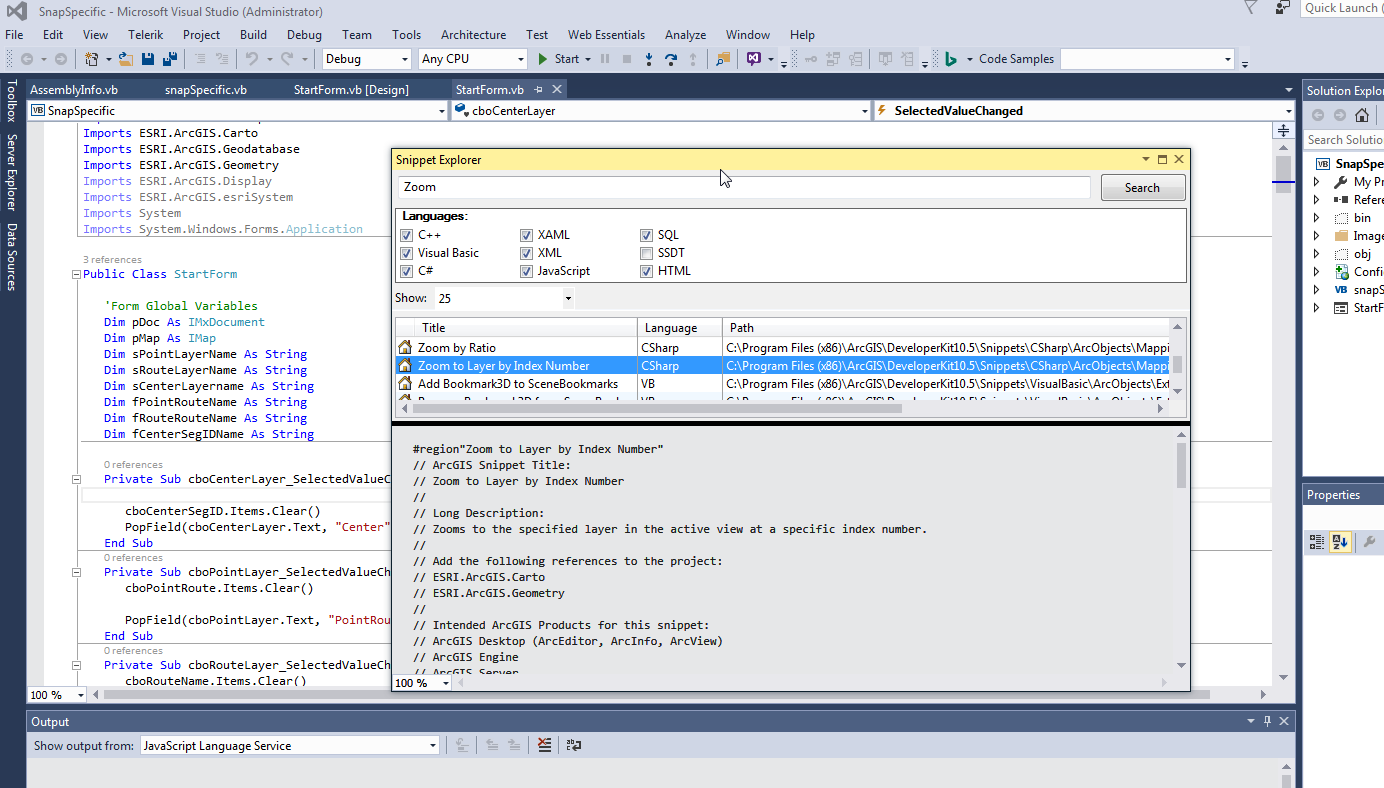

Snippet Designer - Visual Studio Marketplace     <--This plugin will allow you to search and maintain your snippets
View -> Other Windows -> Snippet Explorer
This can be attached to your interface as a tool as well
