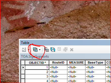

I have a client-side javascript API solution, but it is so non-robust I have to severely limit the geographic extent of the query so it doesn't just time out.  Limit it to the point that it is pretty useless.  So I want to make a geoprocessing service to handle this, but I CAN FIND NO WAY TO ACCESS RELATED RECORDS THROUGH MODELBUILDER OR PYTHON.  Despite the fact that in ArcMap the related records come back automatically and can be gotten at with the touch of a button.

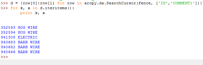

Example of what the key, value pair dictionary looks like.
