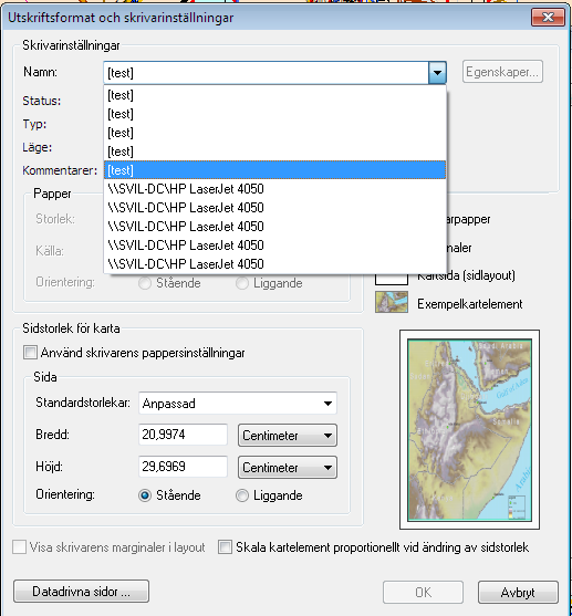

it's about custom ArcMap application(extension), but below you see standard print dialog. The problem is that after opening and closing several documents smth is leaked. GDI objects count grows to ~2 000. Then combo box in the dialog no longer works. It may heal itself after you open another document, or just close this dialog.
simptoms:
1. combo is unable to draw icon(or is it some bitmap?)
2. combo closes itself after 0.5s(there is SetTimer call inside PrintOutUI.DLL). Why would they use a timer?

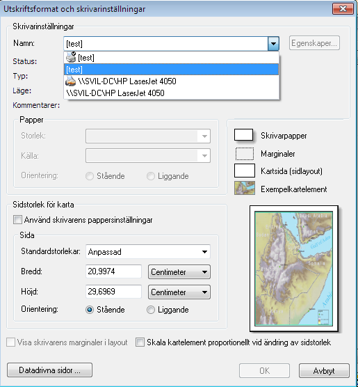

3. in the 2nd picture you see how it all starts - on every click it adds more duplicates.
any ideas? is it possible to make some magic call somewhere to fix this, some workaround(except export to PDF)?
