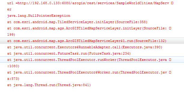

But when i use my own server url replace the official ArcGIS Server,like this
ArcGISTiledMapServiceLayer tileLayer = new ArcGISTiledMapServiceLayer("http://192.168.0.133:6080/arcgis/rest/services/SampleWorldCities/MapServer ");
mMapView.addLayer(tileLayer);
there is a running error is the Logcat and no map show in MapView
I have install ArcGIS For Server,and  a service named SampleWorldCities is running.
And i can visit the url http://192.168.0.133:6080/arcgis/rest/services/SampleWorldCities/MapServer in explorer
And the url http://localhost:6080/arcgis/rest/services//SampleWorldCities/MapServer?f=jsapi can show the map in explorer too.
So what can i do?
omega_cancer
Is http://192.168.0.133:6080/arcgis/rest/services/SampleWorldCities/MapServer​ a DynamicService? ArcGISTiledMapServiceLayer works with tiledservices. use ArcGISDynamicMapServiceLayer class if it is dynamic.
