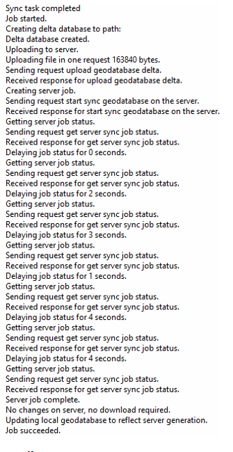

Everything goes well. The synchronization ends with status “Succeeded”. The messages logged by the SyncGeodatabaseJob are like on the screen below:
However – when I open edited feature layer from server inside map web client I cannot found any of my local changes.  In the serve database I can also see that no new records were created during synchronization.

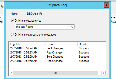

The “Last Sync Data” is equal to replica “Creation date” However, in the replica log in ArcMap I can see the following information:
Can anyone can tell me how should I interpret above described situation? Am I missing some steps in my code? Or maybe some configuration feature is missing on the server? It looks like data modifications are successfully pushed back to replica on server but after that replica is not synchronized with server database (should it work automatically?).
