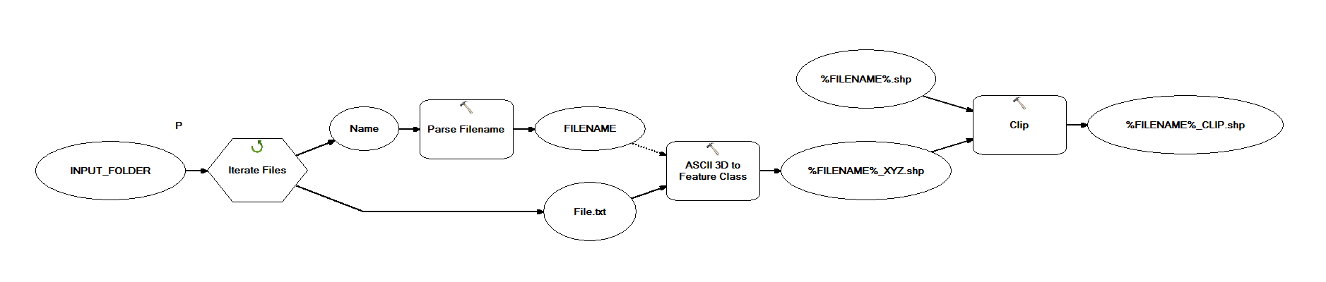

I'm trying to build a model that will iterate through a series of xyz text files, and clip each text file using a similarly named shapefile on a one-to-one basis. So example01.txt has a corresponding polygon shapefile, example01.shp, which will be used to clip it. So I've parsed out the filename, example01, but when I try to use that as the Clip Feature in the Clip tool, the model refuses to start, claiming that %filename%.shp does not exist. What am I missing? Is there a way to do this?
I've already tested a simpler model that will convert the text files to multipoint shapefiles, and that works on its own. But I can't get Arc to recognize that it needs to evaluate the filename variable prior to checking for the existence of the shapefile.

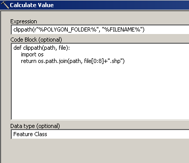

I contacted ESRI Tech Support and they confirmed that variables can't be used as inputs to a process. So you have to use Calculate Value with some python code to generate an intermediary output, which gives you more freedom to parse out particular substrings from a filename, anyway. Working version shown below. Thanks, everyone, for your help.

Full disclosure, I don't use ModelBuilder very often, but this sounds like a job for a precondition.

I've already got a precondition between the parsed filename and the ASCII 3D to Feature Class process.
EDIT: I've also tried making the parsed filename a precondition to the Clip process. Neither worked.

Oh, I think I see. Try using the full path to the shapefile. For example, C:/yourfolder/%FILENAME%.shp
Or, have you set the workspace environment?

Yep, tried that, too. Both using %INPUT_FOLDER% as a variable and just manually entering the path. It's still saying %filename%.shp doesn't exist.

How do you have the Parse Path tool set up? And, is it the Parse Path tool renamed, or a different tool called Parse Filename? I don't have anything called Parse Filename. What is the exact output value of FILENAME?

It's Parse Path, set to Parse Type = NAME. I renamed it because I was playing around with parsing some paths and such. The exact output value should be, e.g. 840_0810 (UTM easting/northing values that were used to create the filenames). So 840_0810.txt should get turned into 840_0810_XYZ.shp (which works correctly in the simpler model I mentioned), which should then get clipped by 840_0810.shp (a polygon shapefile created prevsiously) to create 840_0810_CLIP.shp.

Try adding a second Parse Path tool to the Name variable, set to Path, and named "PATH". Then, change your Clip tool to look for:
%PATH%/%FILENAME%.shp
